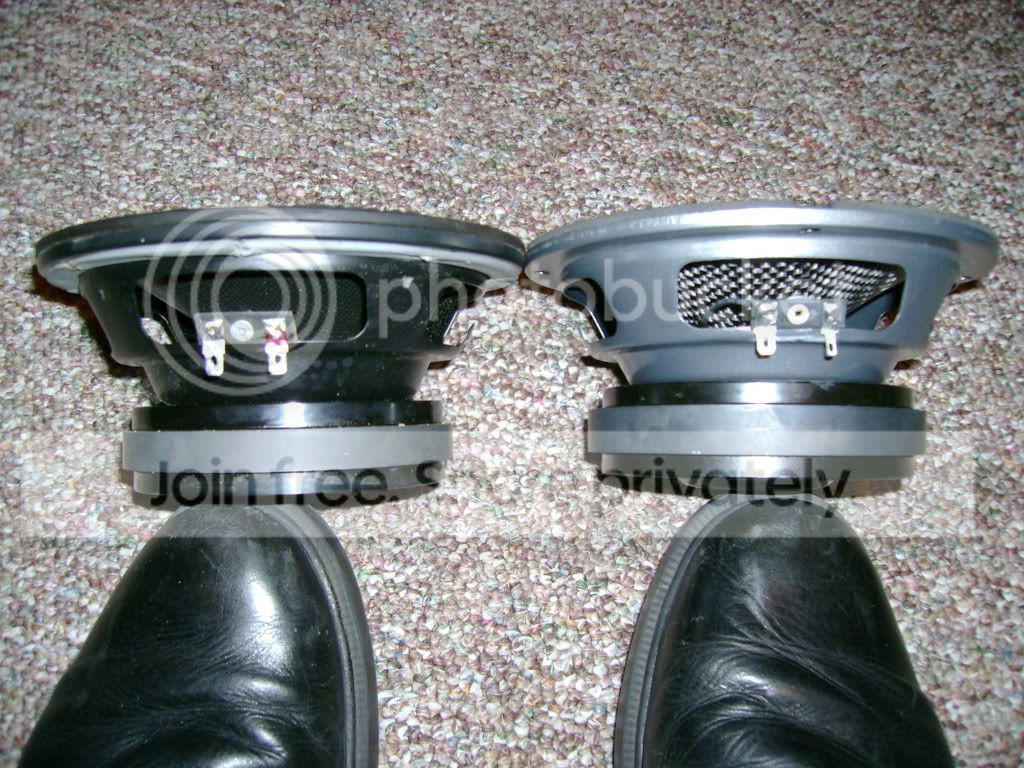

Is this possible at all even with spacer? I searched and seemed like the preferred depth is 2.5 and under. But the speakers I'm getting soon has a mounting depth of 3.1".
Not a picture of mines, but here's a side view of the speaker.

No one is replying, so I thought I would at least offer the following comment.
I doubt this speaker will fit the stock front door position. I tried fitting Focal 165 V2 (Depth from wall: 68mm (2.7")), and it would not fit in the stock front door speaker location.
--Spike

^^ If you don't want door pods or kicks...
Focal 165 V Slim (Depth from wall: 56mm (2.2")) fit the Z's stock door position perfectly, and they sound just great there. I placed the tweeters into the A-Pillars.
--Spike
