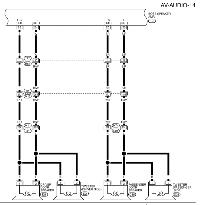

I have an 03 Touring with Bose System and I've been having an issue I think I just made worse today, and can really use the forums' expertise in the issue.
My speakers on the driver's side seem to have been shorting out for a couple months and just giving the kneepad a love tap has done the trick until this morning when doing it left my whole left side of my car without sound completely. It seems as though it's a short of some kind, but I can't seem to locate it.
Has anyone hear experienced the same thing??
Is it the amp, the speakers or the head unit that's causing the problem and how can I fix it without changing the head unit and speakers??
Thanks in advance for your responses!!

Troubleshooting the Bose system is a headache.
Door speakers are powered by the amplifier. Line level signal is from the head unit. Without the proper instrument to look at the signal, diagnosing the culprit is a guess at best.

Do I need an ohm meter, would that work??
