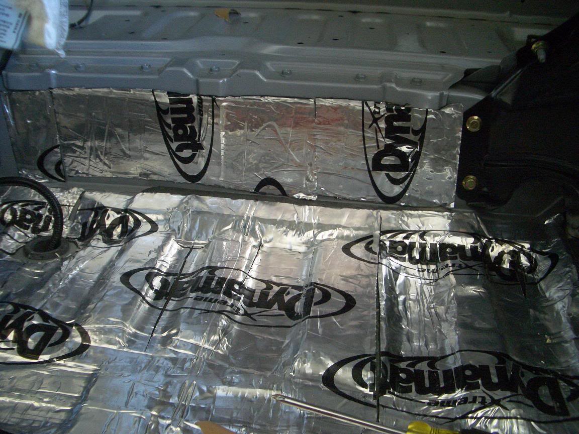

I used dynamat along with another foam material on top and I didn't notice any difference at all. In my opinion from my experience it wasn't worth it at all.

This is what mine looked like. I only used dynamat because I used my employee discount at Best Buy and got it cheap. Hopefully your results will be better than mine.

I did my trunk and the inside of the trunk plastics and it made a pretty noticeable difference for me And I used eDead which everyone seems to think sucks.

I did everything behind the seats with one layer and two layers over each wheel well. Prior to the treatment every single little pebble/grain of sand made noise. Now not so much. The smell went away after a few weeks. I don't buy the magic juice but only the added mass makes the difference, the thickness isn't enough to make a frequency difference so the primary effect is the added mass. A heavier object is harder to get to move so sound energy has a more difficult time vibrating a treated panel. Peel and stick or paint it on works IMHO
