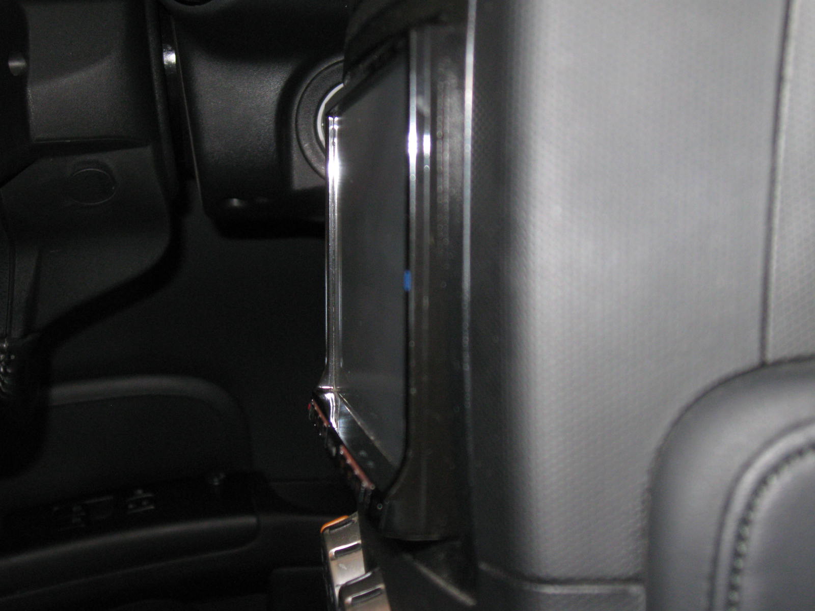

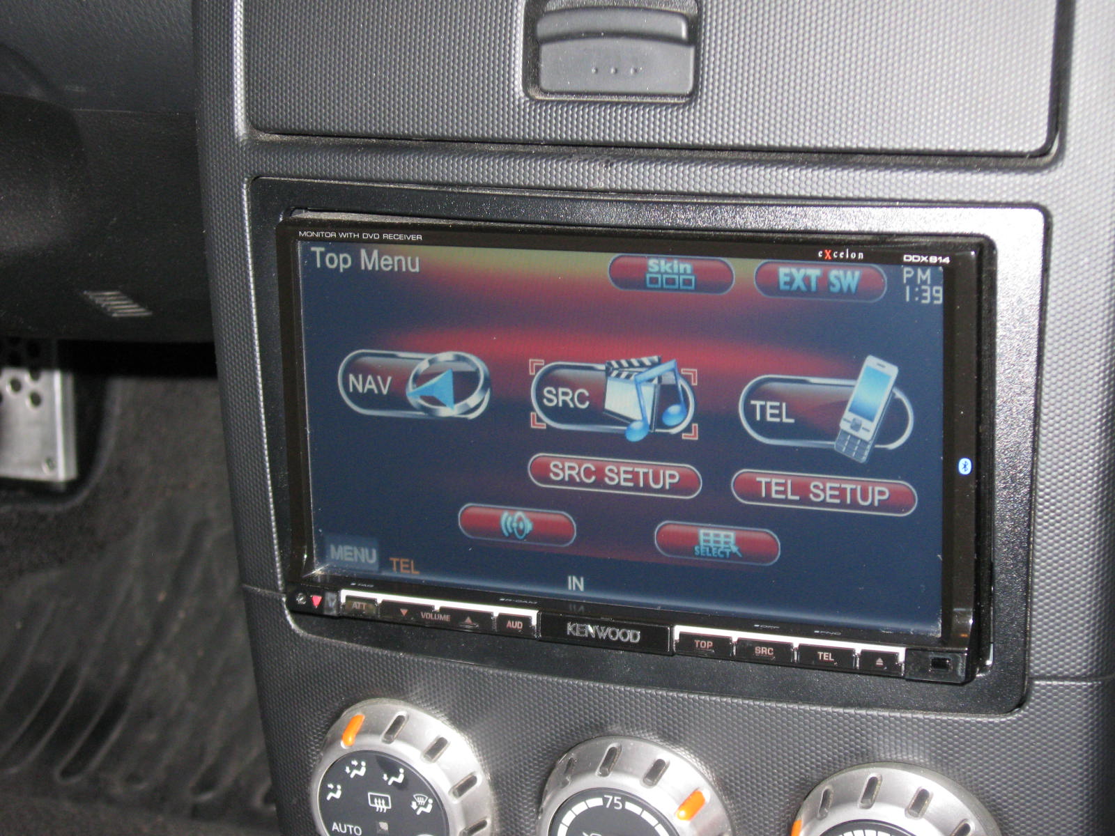

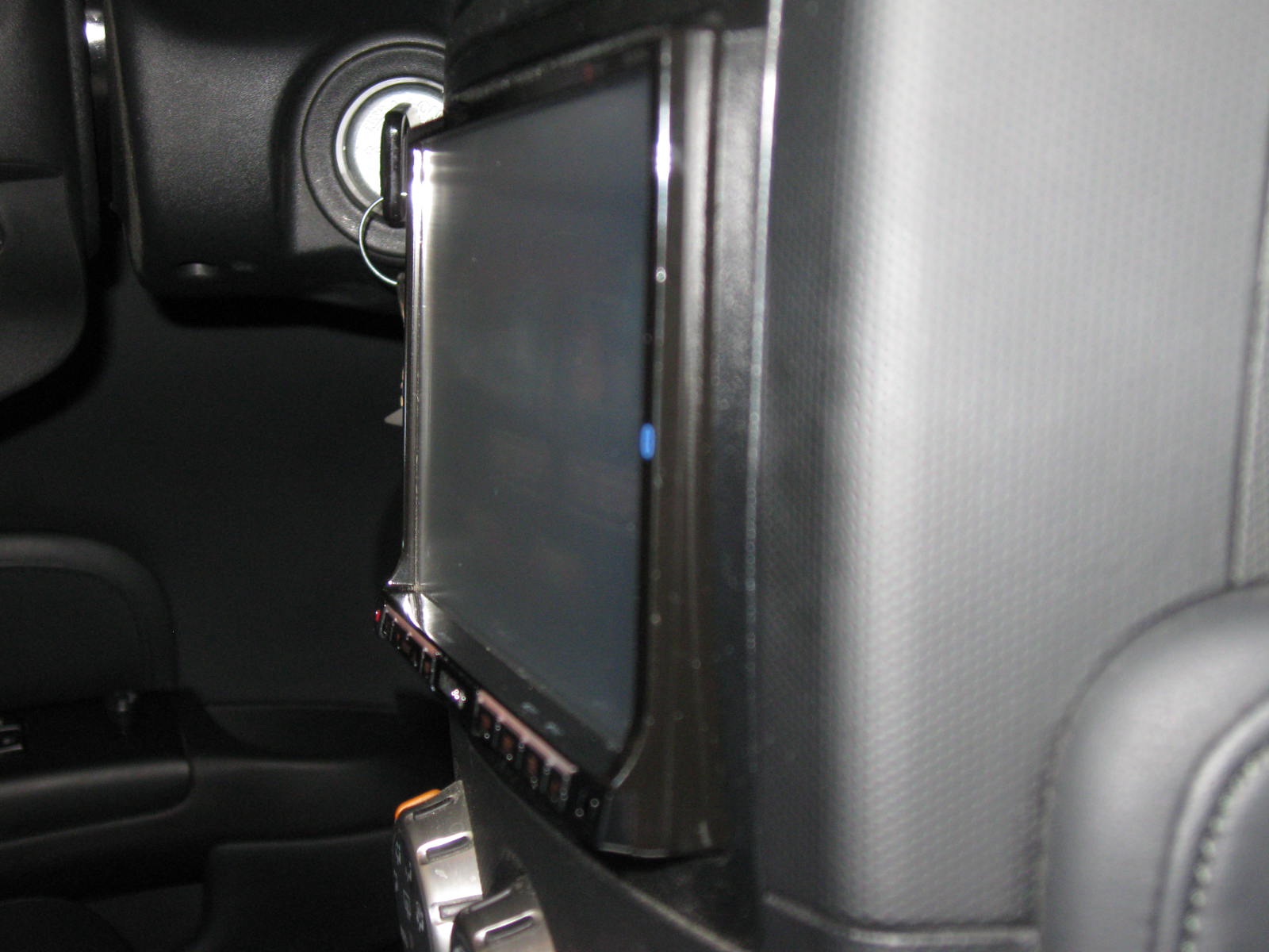

I'd like to clarify something. My stock (as per Kenwood factory) DDX-814 does not fit "flush". Which is to mean totally flat with center console as does the stock unit. But, it sticks out a little as mentioned above because the screen does mechanically move out to allow DVD's to be inserted into the unit. However, it does not stick out that massively as does the OP's Alpine unit. To me, the Kenwood looks factory as if this is what Nissan should have put in the car.

Nice, I like how that Kenwood fits. My JVC sticks out about 1/8 " bit more than that. I consider flush, 100% flush. I don't see how that can be done with a motorized removeable face.
