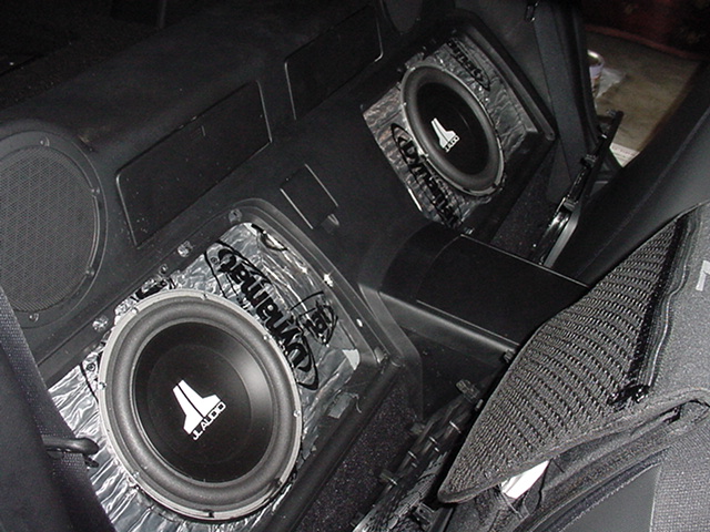

I did 2 JL10w3v2 behind the seats (removed the glove box). Yeah in the hatch would be louder, but I was going for the quality not the window rattling effect. With my amp (JL 500/1) gained down as well as the deck, the subs still hit hard as heck and sound awesome. Key is definitley sealing all the little holes though and using enough polyfill.

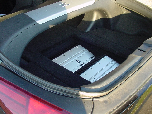

Thanks Shujun... here is a hatch picture that leaves the hatch area still usable ... it has a tinted piece of lexan over it now ...

Hey 350Z that is an awesome stealth setup. Did you remove the spare to do that or is there enough room for both the spare and the amps?
Which amps are you running?
Have you replaced the stock speakers ?
Thanx
Shujun
Old Dec 12, 2003 | 07:08 AM
350trackz's Avatar
350trackz
Joined: Oct 2003
Posts: 480
From: Sittin' Pretty the the Big D
spare is gone ... just bumped up the insurance $5 every 6 months to cover towing I am running the JL 300/4 for the door and rear speakers and the 500/1 for the subs. I have replaced every audio component in the car. I run the JL 650Csi up front and 650 Cxi in the rear and Alpine 7998 for a head unit. Music is quite crisp and can be very loud if need be.
I did all of this in my garage so if you have questions ask.
