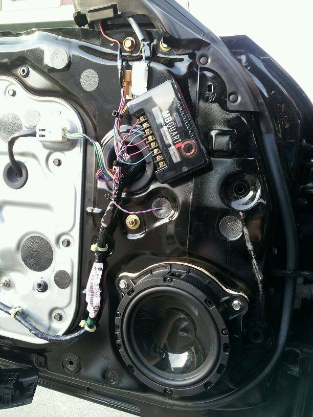

Just a heads up for anyone looking to buy MB Quart ONX216 Components for the front doors; they do fit. We used the stock speaker with the speaker cut out and jigsawed a piece of 1/2" (very important that it's 1/2"!) plywood for the additional space so it wouldn't hit the window OR the door panel. Here is a picture of the set up of placement for the crossover and the custom 1/2" plywood behind the stock spacer.

Nice, clean install. But how do they sound? What kind of power are you running them off of?

Thanks man, so far so good. Installing MB Quart 116 Coaxials in the rear as we speak. Running it out of a Pioneer AVIC 140BH head unit. I'll let you know when it's all done!

Nice fit. Some sound deadening in the door is always helpful
