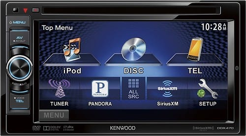

I was thinking about this headunit:
http://www.bestbuy.com/site/6-1-cd-d...x470&cp=1&lp=1
It's A Kenwood.. , Touchscreen,.. but a little bit of "best of both worlds" sort of thing with analog dial for settings, volume buttons and other such on the left hand side.. and touchscreen as well, just .9" smaller than the one I have.
It's a reasonable price.. and have 4V preouts.
Think I'm going to head over to bestbuy in an hour or two.. maybe they can slap this in this afternoon/evening.. Or, I MAY just buy it and put it in myself.

Finished! -- Went and bought the Kenwood DDX470 and BestBuy couldn't install today.. So I just brought it home and installed it.
Here she is done:
http://www.flickr.com/photos/111739693@N04/11990754885/
http://www.flickr.com/photos/111739693@N04/11991567776/
I really like this headunit.. It has more features for Audio.. Built in Front, Rear, and Sub crossovers active -- Very handy.
I love the actual volume ****, attenuate button,.. Phone button etc.. Where I don't have to look away from the road. Still a 6.1" touchscreen and DVD player.. best of both worlds.
Bluetooth works excellent,.. It's new for me to have it in my vehicle, so it will get a lot of use.
There is a difference in this HU and the Pioneer one though.
To get the proper voltages when retuning the amp.. I had to bump the gains higher using this Headunit.. Despite it having 4V pre-outs as the Pioneer had.
Particularly the Sub channel.. Sub channel is probably 85% or so now to get it to the level needed. (That's at a 79hz tone.. at 40hz.. the voltage is WAY higher.)
The fronts/rears didn't need much of a bump.. about 10% compared to the Pioneer.
Sounds great though!
And.... she's done! My hands can heal.
Thanks for all your help.

Interesting find on the voltages... maybe they are really like 3.8V and for marketing sake they just rounded up Or it might have to do with when each units hits the 4V level. For example I've read that some radios reach their limit early and go into clipping where others never reach the full voltage because they leave some head room in for dynamic range. What happens when a head unit has a built in EQ? In theory it should only hit max voltage when the EQ bands are boosted.
