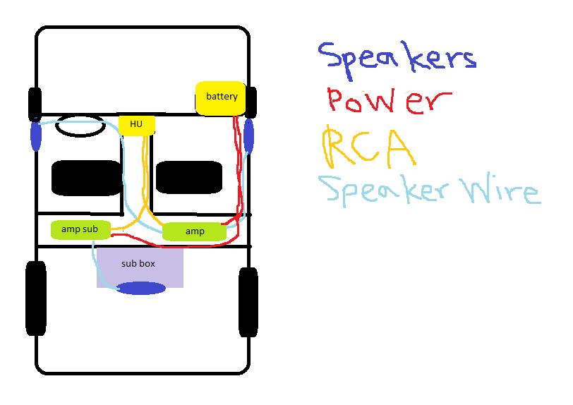

Q:Where do I run all the wires?
A: The picture below shows a typical 350z setup with 2 door speakers and a subwoofer in the trunk. All wires are hidden under interior panels (center console, side panels, etc)

the important part, as you have done it, is to run the RCA signal separately from your power cable to prevent interference. I did mine exactly as you diagrammed, except I only have a single 4-ch amp, with 2 channels bridged to my sub.
Thanks Nismo dude. I wasnt sure if speaker wire is supposed to be near power cable or not...Only RCA cant be near eh? Sweet! I think im ready to jump into this install!
92k, wuts photoshop?
This is often the source of that awful "alternator whine" that can be heard on a poorly done install.
