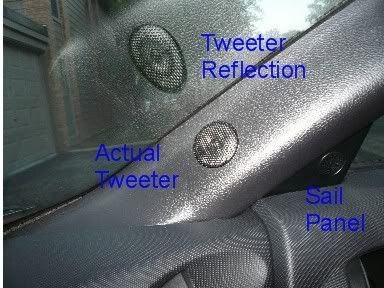

Saved, You can move the tweeter farther forward and gain a big improvement in your “sound stage.”
I mounted the tweeters in the A-Pillars aiming them at the windscreen with an angle that bounces inside the driver and passenger seats.
That provides a good tweeter sound for both seats instead of the compromise you get when mounting tweeters in the Sail Panels.
Did the tweets get brighter bouncing off the glass?
Out of curiosity what'd you to use to cut such a perfect sized hole for your tweets in the a pillar? A circle cutting bit or just a dremel and patience?
Debating buying some tools to do some more modding...have the dremel...but might be picking up some other goodies...curious what you used.
Saved

The picture....do you happen to know how to remove that piece with the fake vent? The one that is next to the base of the a pillar basically...has a little vent looking opening but it's fake, there's no air flow through there whatsoever...I'm eying it as a possible location for a mod but I'm not sure how to remove it?
Any help is appreciated, as I've had most of the Z interior disassembled before (by me), but never have I done the front dash....hoping that little piece is easy to get out...would make my little idea much more practical if it's simple to remove and experiment with.

That's the defrost vent...

And you want them angled towards the center if possible instead of just straight up.
