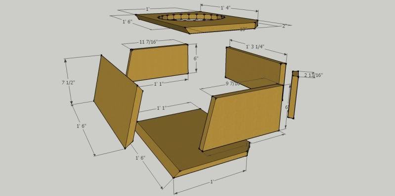

Another thing to consider coop: If you fiberglass the inside of the subwoofer enclosure, you're going to have to work around your fuel pump access port. I'd go with something you can just slide in and out of that space. The prefab enclosure route is probably the best way to go, even if it seems expensive. The time and headache you save are worth the few hundred bucks. Trust me.
Also, just using Dynamat to close out the airways doesn't work on a sub (free air or otherwise). I know. I've tried.

Thanks zak, after helpful comments on here I've decided a box secured in that location is best. I email the company earlier this week to see if they'd ship to Canada. I'm down to spend a bit to save hassle. If not, I'll just build it myself as it shouldn't be too difficult. Might prefer some Dynamat to put some in that area to reduce some rattling.
Appreciate everyone's insight. Hoping to bring the car out of storage in a couple weeks and then will start ordering parts.

Thanks guys. I brought the car out of storage last night and this morning spent a few quick minutes messing with the settings .I was able to get some decent bass out of it. Quality is still meh, but I didn't play with the face at all. Since I seem more limited than expected, I'm going to play with these a bit more and go from there .

I was searching old threads and found one where someone built a wood enclosure that fit inside the stock location and fired up. A few people had similar setups and seemed to like it. I thought I bookmarked the thread, but apparently all I did was save the picture with the box and dimensions.
I'm not opposed to picking up some 6x9's for rear fill. Just seems like a bit of work and not sure I'd notice them much to be worthwhile. My s2k only had front components and a 10" in the trunk and sounded fantastic.
