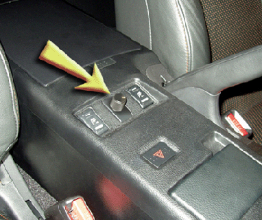

Installing the BassLink remote control **** in your Z center console is another nice addition.
Attached Thumbnails To go aftermarket or keep the Bose that is the?????????-zbasscontrol2.gif
