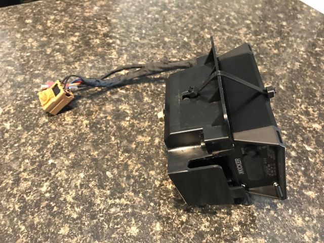

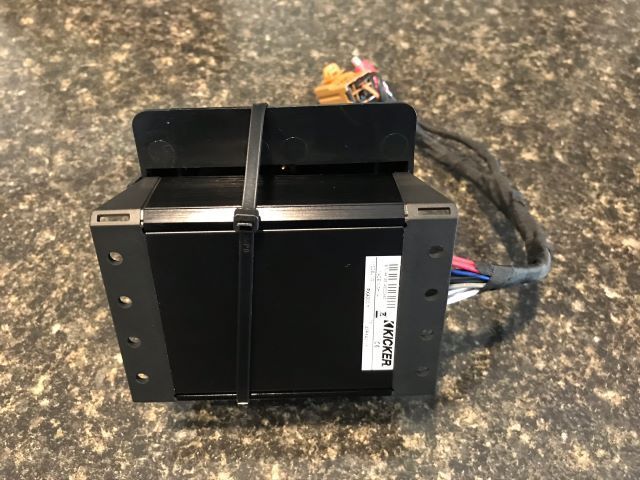

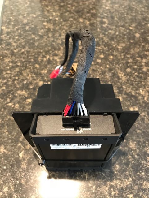

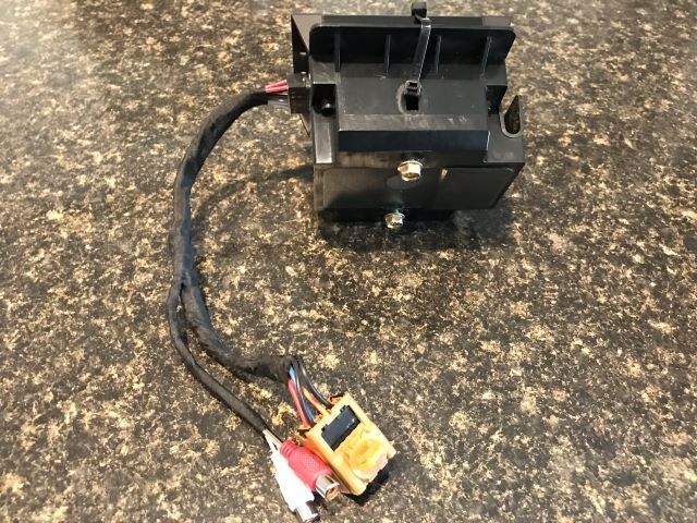

And went on to install it in the car. The reason I took it is because it works with 0.5 ohms (same impedance as the OEM sub), can pack 200W RMS, plenty for the original sub, and doesn't need any additional wiring. But I ran the sub RCAs from the radio to it. This way I can control the sub level myself, and bypass the Bose's level control.
I can say that the base is much improved. It almost (I said almost) punches as an aftermarket sub in the trunk, without any additional wiring or using the minimum real state.

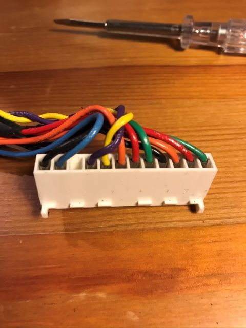

Here are a few pics of the new professional "package". I've even reused the same OEM connector, attached to the new amp cable. I had to reduce the gains on the amp quite a bit, since the OEM sub started to distort. No electronics or gimmicks, just the old fashion ear. If there is a next step, there would be to add a 0.5ohm sub at the same position, like this one: https://www.crutchfield.com/p_206CWR....html?tp=68872. But not inclined to spend the money on this now.
