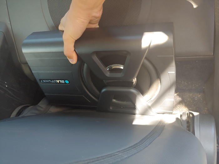

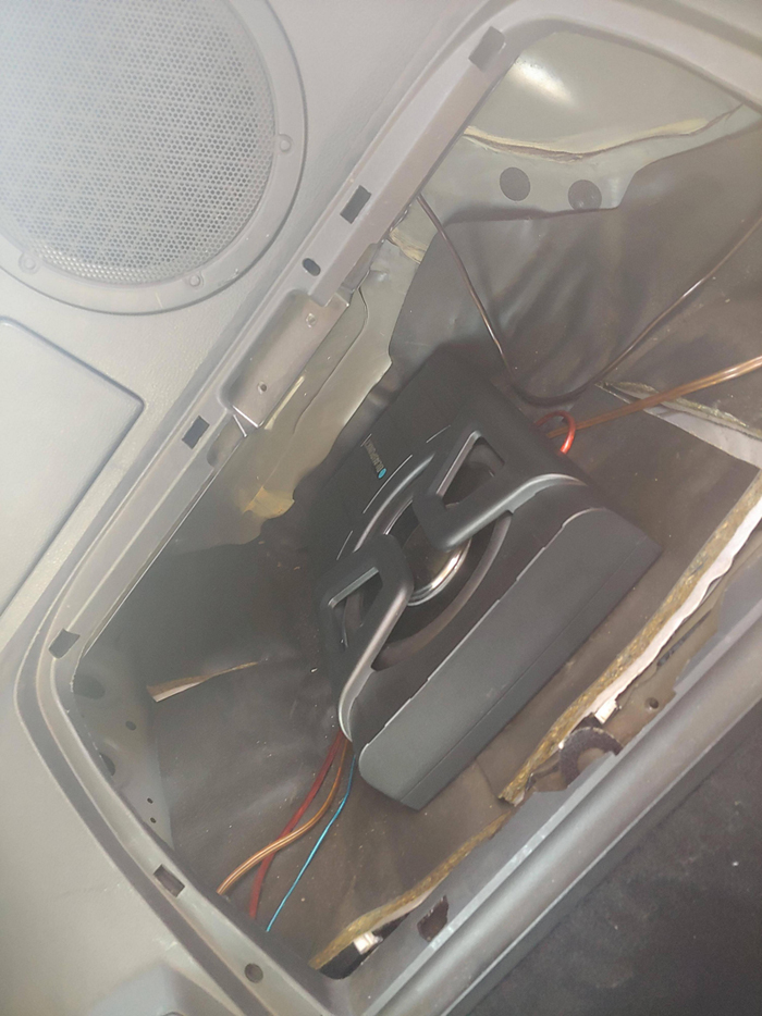

Misspoken, it wasn't under the seat. It fits behind the seat on the floor up against the back which would depend on your seating position, I am 5'10. I had my seat nearly all the way to the back and fairly reclined, and it was well hidden. I've had several sound system setups so it kept getting redone over the years.
Edit: Here are some pics of how I used to have it installed. It fits there with room to spare. IIRC you can slide the seat all the way back and it would still fit snug.
Another option is the JBL Basspro Hub spare tire powered sub. My trunk is now stripped so I have more options for bass but with age I have had less interest in a system.
I was literally just out at my car taking measurements of that exact spot thinking it would fit there lol. I only worry about it overheating in there. Couldn't even wire a fan to blow on it somehow. I am 6' but I don't push my seat all the way back because I prefer an upright driving position. Did yours ever overheat? How did that thing sound? Nice enough to fill in the lows for at least electric pop music?
I understand not wanting the big bass as we age. This is why I am leaning more toward an 8". I do want SOME bass though. When I got my car only one speaker worked so I first put in the android auto unit. Then I replaced all four speakerS (2 were blown, one was not connected correctly somehow) with infinity ones with the woofer and tweeter in the middle. So recently I wired in a 4 channel amp I had laying around. With all that I now have a ridiculous amount of highs and mids but no lows and it sounds funny. Sounds like I have a blown sub because..... I have no sub at all

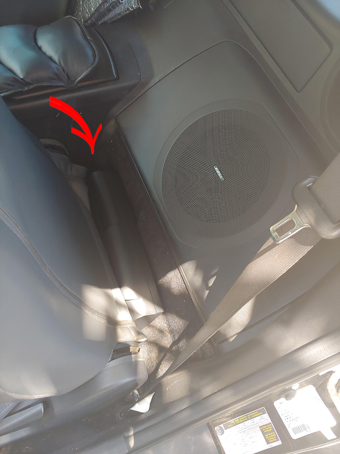

If it isn't loud enough for your taste, move it into the stock Bose location. IIRC it sounded deeper under the seat but was louder in the Bose location if that makes sense. I tried it in several locations in the car to see how it would sound. I took it all out for weight savings.
I'm assuming the resonance is what makes it loader. What did you use to secure it back there? I'm wary of drilling anything since it's literally right on top of the fuel pump

That's what I've been saying, mine is bolted to the chassis and facing forward in the Bose location. Love the way is sounds and I have a bass boost remote hidden in the center console.
