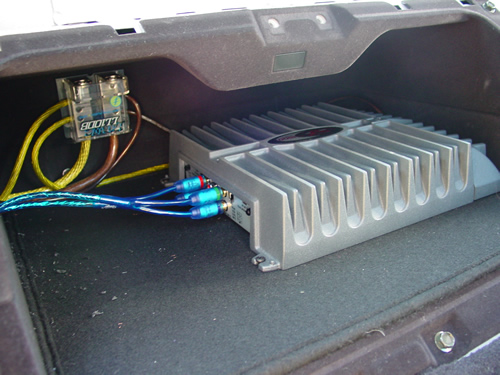

Amp setup, I did vaccuum since

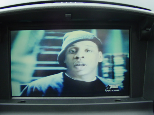

Farenheit T-7001mhr perfect fit, hard to tell in this pic but the picture quality is excellent for the $$.
