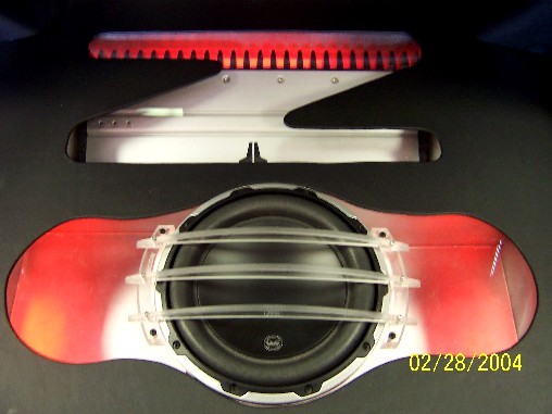

If you have a coupe then the best posible bass and clarity would be in the trunk facing up. You can have an elabortae setup and still not get good sound. Lucky for Z owners, the car is made extremely tight and there is little or no need for dynomat. The reason it sounds best facing up is that the bass reflects from the glass in the hatch and goes forward. It fils the car with a clean and crisp boom everytime. Along these same lines, sound from the tweeters are also better when reflected off the front windshield. Here is a pic of my sub setup:

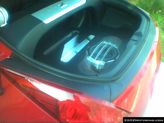

Here is a pic with the neon on
