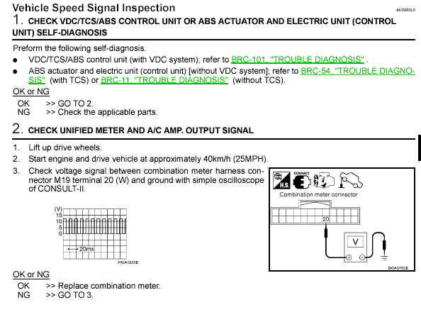

Do not use this wire diagram, but here is a pic of the vss (vehicle speed sensor) diagnosis page:

...and finally the wire you need to tap. Form the white ac amp/unified meter control (white box under the head unit), from the 2nd grey harness (3 total, 1 white, 2 grey) tap wire 26 (WHITE) -- see the connector block diagram above for location. This is the vehicle speed sensor wire.
So many people with the same resources and no answers to this questions... geesh ! There you go... DONE !
