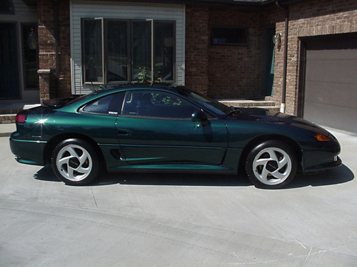

The cleanest Stealth you ever saw...
....as soon as I get a chance to compile and post all these photos! Pix are okay, but pretty good for taking them with a Olympus w-10! Lighting was not always optimum, as most work had to be done eves...but I will get them up in a 7-10 days.
My car's been down for 5 and 1/2 weeks....sniffle. I have had to drive just 1 car this whole month. But will be back up by this weekend. Anyone having questions on audio equip, email me. I know that piece of shet Bose system perfectly, after hours and hours focking with that head unit, an ohm meter and continuity tester, both "amp(s)", and the wiring. Originally, since I have NAV on the car, I wanted to keep stock head unit and and keep the car clean and original. TIL I SAW THE baddest piece of electronics ever - the Kenwood ddx-7015!!! Double Din, clean looking, touch screen, multi-expandable system. This little basterd will even wash the dishes(if you get the add-on adapters/modules!) Well not really, but almost.

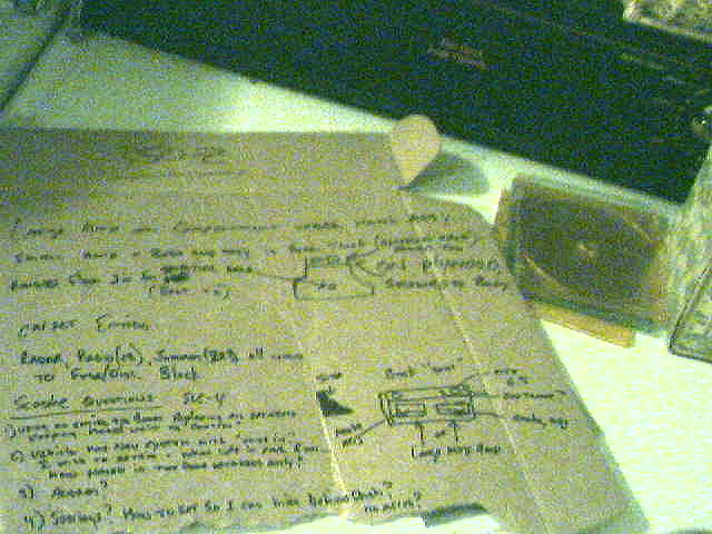

First, a plan...... here are my initial ideas, wire routes, colors, etc.

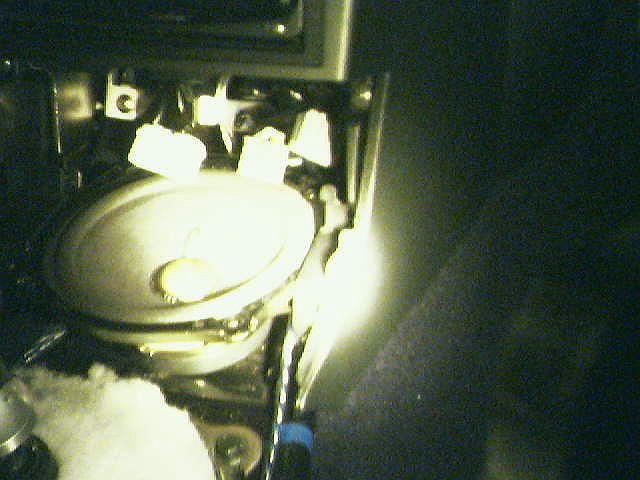

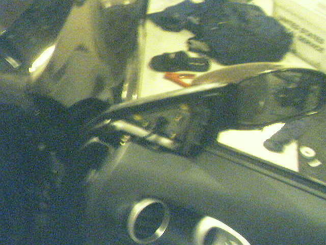

This is corner tweeters being put in...again, sorry for crappy pix. Tiny camera/voice recorder thang. Actually takes amazing pix in the day!

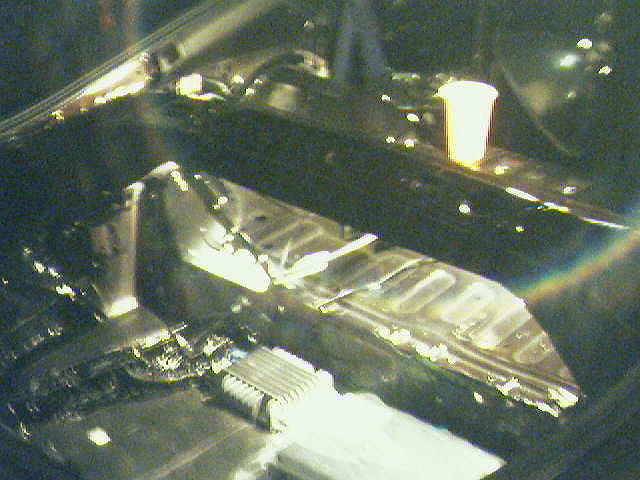

This is during work, cant see inside car too well, but youcan see tower is stripped of all plastic.

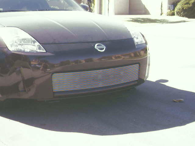

This is car exterior where i installed side marker lights, the Greddy front lip, but before my Ings +1 body kit went on. It was getting painted....

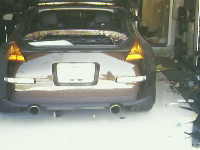

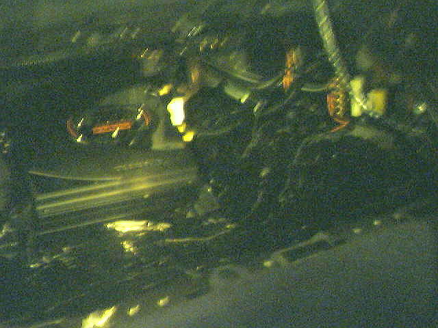

Exhaust system en route......car is totally disassembled inside. I literally had to trape wires together and steer with half the dash in my lap to get it to this shop with a lift to do exhaust. I was "multitasking" on the upgrades.

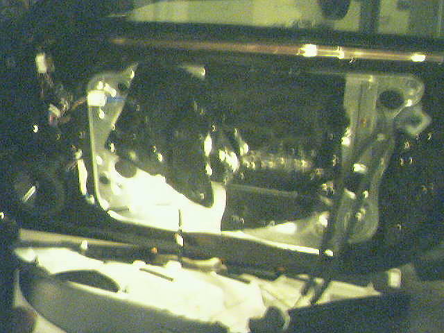

passenger door apart... being dynomatted, and I used facrtory speakers as mount for new speakers. Cut out the guts of the factory speaker, and used plastic spacer of factory speaker to avoid the new speaker from being hit by the sliding window.

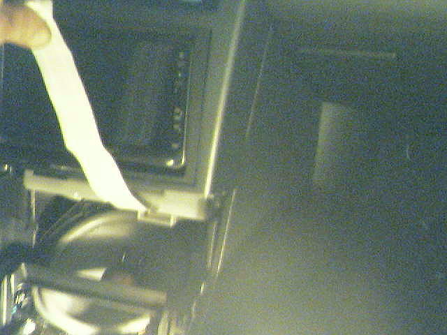

this is what your dash need to look like to install. Damn, I kept having to tear more and more apart....even got the headliner removed at one point to mount my two bacon sniffers. (Anti radar/police units)
