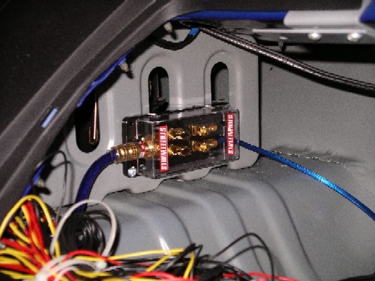

If you have 2 amps I would go with a distribution block downstream of the inline fuse near your battery. That way you will be 1 large fuse (80 amp) and then 2 smaller ones for each of the amps.
And STU did mean do not tie the power and signal wires together. But you must also be sure not to run the signal wire next to a vehicle power line. There are lots of "hot" lines all over the car.
Here's a pic of my distribution block.
