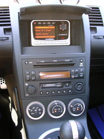

Yes, the new Bose HU's are satellite ready. It enables you to use the radio button to toggle to SA1 & SA2. I used a NIS PAC to directly hard wire the Sirius receiver:
http://cgi.ebay.com/ws/eBayISAPI.dll...sPageName=WDVW
It definitely sounds a lot better than a FM Modulator set up. It has no hiss & provides CD quality sound. It completed my sound system & am very happy w/ it.

Im somewhat confused.
If you buy the gadget from ebay then all you should have to do is have the default bose hu, the gadget, a tuner and an antenna.
Why do you have the setup in the cubby?

Yes, I had the single CD Clarion HU in my Enthusiast & bought a 2004 6 CD Bose satellite ready HU (black face) from Ebay. It works with the Audio Link LOC & harness from (linkmeup.com). I then installed the PAC NIS to hardwire the Sirius satellite Audiovox PNP2 receiver in the cubby to the Bose HU. Just beware when buying the 6 CD HU as the CD mechanism breaks in shipping. It happened to me twice & had to have the CD assembly replaced ($250). The HU needs to be shipped in a locked position w/ a white plactic lock on top to avoid internal CD components from being jarred & breaking.
"Your Bose does have the ability to control the satellite without a seperate unit. May be a more expensive option because you have to buy the adapter from Nissan (tuner to hu)."
In order to subscribe to XM or Sirius, you will need to purchase a receiver. If your Bose HU is not satellite ready (old 2003 model-grey face). You could use a FM modulator connection (sound quality comparable to FM stereo). However, if it is satellite ready then the sound will be CD digital quality.
