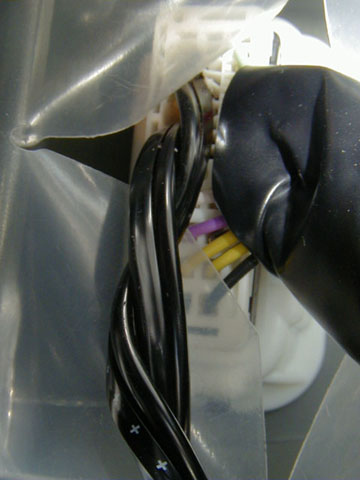

first pic, getting wires to the door. Had to drill the MOLEX (thanks subwooer) connector so that the wires did not show.

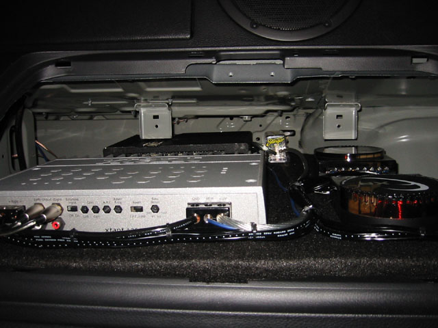

anyway, so here is a pic of the amp "rack" I made for both amps
note, this is a fabulous place for the crossovers, cuz you have to tweek the heck out of the equipment so that it sounds reasonsble playing off of the terrible head unit.
I actually had to end up puttin the crossovers at -4db for the tweets. The damn clarion has this artificial high frequency boost so the OEM system sounds "clean."

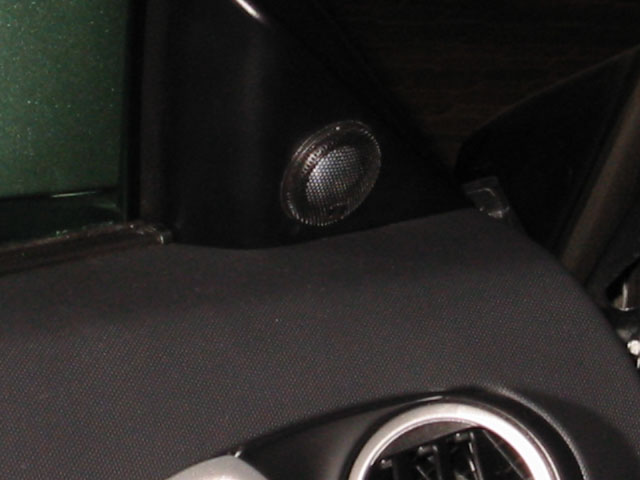

yeah and the tweets are great in the stock position. nizl did the hole for the tweet using a hole saw that fits on a drill. I think he used 1.25 inch? Anyway, the tweets fit in veeery snug and just a thin film of liquid nails at that interface worked to hold them in good.

Oh when you said you were having tweeter problems I thought you had dynaudios like me. I am not sure but it looks like you are using JL or quarts. They are both notoriously bright tweeters IMO and there is not much you can do about it, sorry to say. If they are the JL, it may be fixable, but I've had a couple high end ($800+) sets of quarts and I could never fix the brightness, even with an Audio Control EQL. You still might want to try reversing the phase though.
Did you try mounting the tweeter down lower? That will help a bit. I made bridges out of strapping material and mounted my tweeters above my woofers in the doors. I'm also boring out and recovering the stock speaker grills with grill cloth because they are covered about 1/3 with plastic!?! WHAT THE?! Anyway, if you still have effort it might be worth trying to mount the tweeter near the woofer - you are going to have trouble getting a good soundstage/imaging with the tweeters so far from the woofer.
On the other hand if you dont care about that really, keep it in the stock location.

there is nothing wrong with having seperate wires going from amp. Additionally, anywhere you would put the crossovers under the drivers dash would have to be ghetto tied somewhere.
