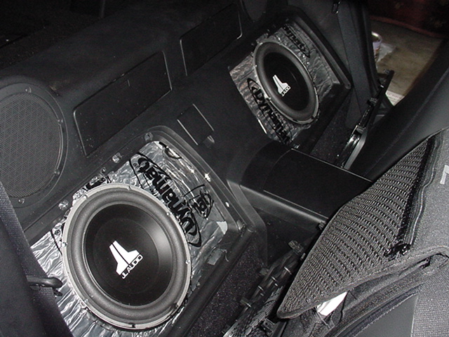

Dynamat all you want, but there is NO WAY you can correctly reproduce bass like that without a sealed enclosure. I'm suprised a shop would even suggest such an install. Nonethess, it looks great. I wanna do the same setup in my car as well. I figured I'll have to go with a custom fiberglas enclosure in each cavity regardless.
I hate fiberglas work. But...

Don't want to hijack, but I sealed the space behind my seat and did a dual JL 10w3v2 behing my seats. The openings are a pain to seal but some dynamat and liquid fiberglass and you can seal it up.
If you have any questions, feel free to ask - mikegronholz@bigfoot.com
As for parts, the passenger side uses the exact same as the drivers...the openings are identical. I have done a glovebox swap on the driver's side as well for a buddy...he now has a glove box behind each seat.
Attached Thumbnails Stero Install Part 2 w/pics-dsc00037.jpg

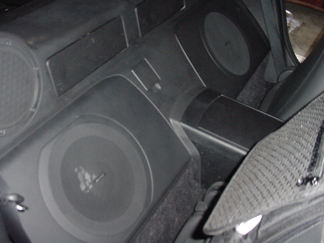

with grills ...
Attached Thumbnails Stero Install Part 2 w/pics-dsc00036.jpg

What's the benefit to having subs face back as opposed to forward? Sorry i'm not too knowledgeable yet with systems
Also, is it possible to have this type of setup while still getting the best sound out? I heard someone mentioning a fiberglass encasing inside. Is there enough room for that and will it reproduce just as good a sound as if they faced back towards the trunks? Thanks!
