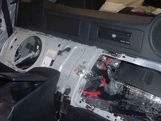

One sub was mounted in the factory bose location and the other was installed behind the passenger. I ordered a second sub mounting bracket from Courtosy for 20.00 which bolted right into the factory holes after removing the storage compartment. No additional drilling was nessesary. Plenty of dynomat was used on the inside of the compartments which helped tighten up the sound. The final result a very clean sounding system with plenty of punch but not overpowering. I couldn't be happier! Here are some pictures.
Attached Thumbnails Stero Install Part 2 w/pics-amp1.jpg

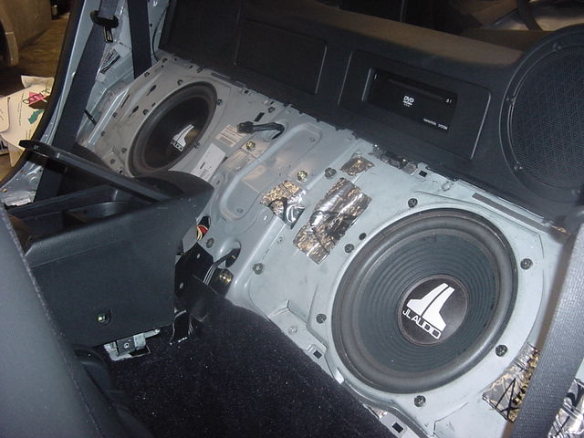

Here are the subs going in.
Attached Thumbnails Stero Install Part 2 w/pics-sub-mount-1.jpg

The finished product!
Attached Thumbnails Stero Install Part 2 w/pics-finished-subs-1.jpg

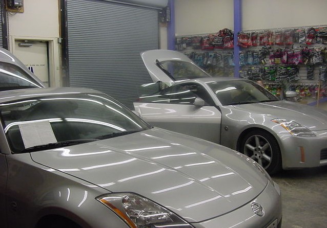

Another Z getting an awesome install at the same time. I will leave the details to him.
Attached Thumbnails Stero Install Part 2 w/pics-2-z-s.jpg

Alphared- The subs are freeair JL audio IB4's. The amp is a Kicker 02Kx5503 and is mounted behind the sub. It's running 65 watts to each set of fronts and 200 watts to each sub. The headunit is powering the rears. The system has a nice frontal soundstage with minimal sound coming from the rear speakers.

Good question. There was one thing that needed some cutting. There were no precut holes behind the passenger seat for the Bose grill so installer had to cut about six holes out for the grill tabs to snap into. Everything else lined up and just needed bolts to fasten in place. For the person that didn't want subs behind the seats and wanted extra storeage space I imagine that you could purchase a compartment and put it behind the driver as well.
