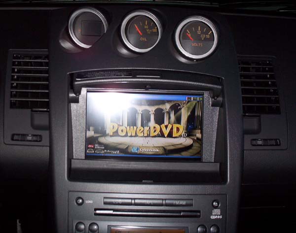

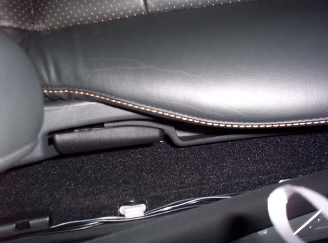

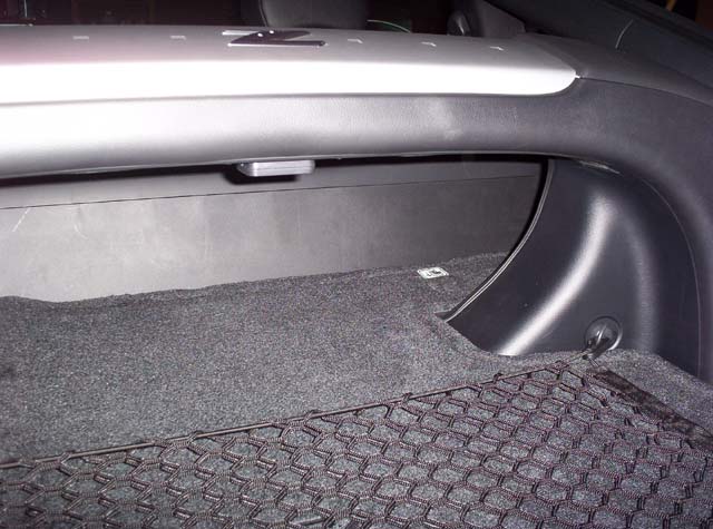

junk underneath the computer in the false storage space.
TV tuner, inverter and cables

RCA wire, power wire for lcd and FM modulator, and remote unit for tv tuner run to front of car under the door trim piece.
I lifted up a portion of the trim piece for the picture....the trim piece is held by plastic clips.
Attached Thumbnails Computer and tv tuner install pics-6wiresunderdoortrim.jpg

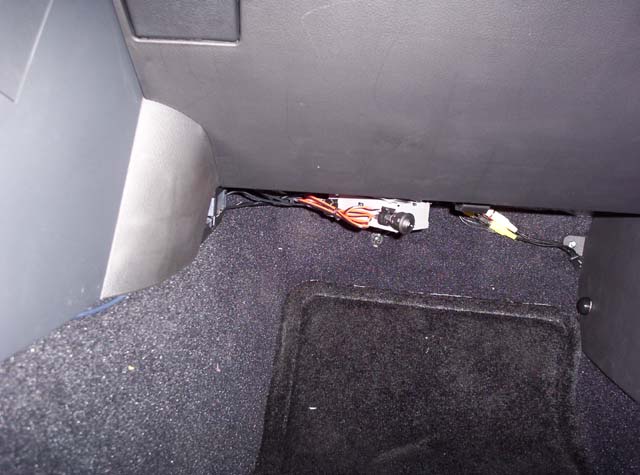

Power wires, fm modulator, RCA wires, and junk under the dash...lcd optical cable run to side of passenger seat.

So are you using the TV out off of the motherboard or an external scan converter for input into the LCD? I'm assuming that isn't a VGA monitor.
Also, are you using the power inverter to the cigarette lighter? Is it directly wired to the cigarette lighter or just pluged into it?
Looking at this myself, but leaning more towards a DC-DC power converter and VGA screen. Just curious how this is working for you so far.

RCA out of motherboard. It's a non-VGA Farenheit 7001.
All 5 of my devices including the inverter are plugged to cigarette lighter...The extension you see turn the devices on/off. I figure I'm pulling a little over 9 amps with everything on....usually just i have just 4 on at a time so the max is about 8 ish. No problems.
DC-DC power is ideal and so is VGA. The inverter works for me and it was a lot cheaper. ....still waiting for a VGA LCD that fits well enough to even consider. Non-VGA requires big text at least font size of 16....with the right programs it will work well.
I love the MP3s and videos so far...I'm getting a antenna for my GPS next week and will be testing that out soon.

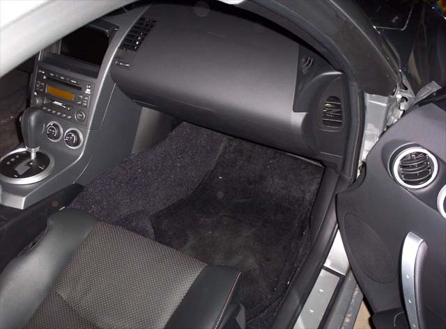

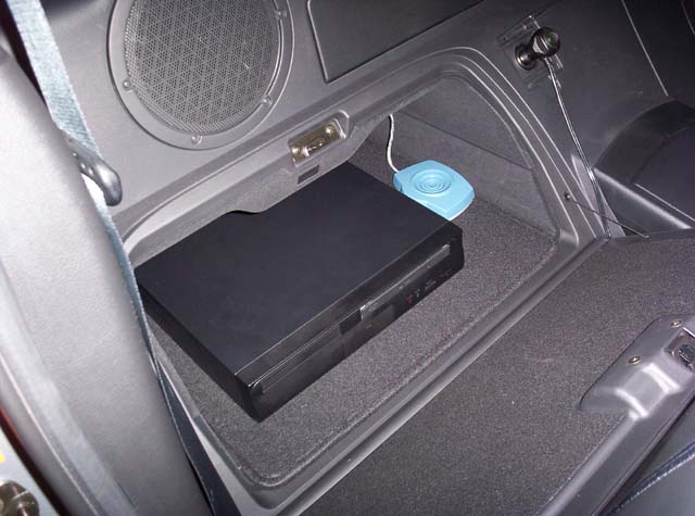

so how do you actually use it? do you have to lean back and use hte mouse everytime you wanna do something?
Old Feb 11, 2003 | 05:57 PM
abz123's Avatar
abz123
Posts: 722
From: Central time zone
The blue thing is a receiver for the trackball and the glove box is closed....I just showed it open to show that the pc could be access without diturbing the passenger. I have a wireless RF trackball that I place on the center console (not pictured). The device works on radio frequency and you do not need a direct line of sight. Works good but big...so I will be changing over to a RF presentation remote of some sort or a hidden touchpad. Keyboard is a virtual keyboard (my-t-touch).

wouldn't just buying a touchscreen be easier in the long run?
Old Feb 11, 2003 | 06:38 PM
abz123's Avatar
abz123
Posts: 722
The smudges and fingerprints would drive me crazy.
Plus, unless your finger is the size of a pencil tip you would have a hard time with most of the program available. You would have to write your own programs IMO to make it really viable.
