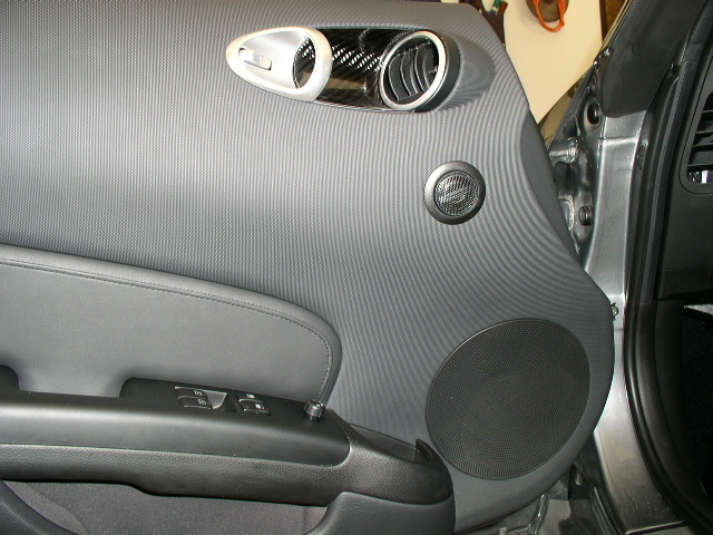

as far as tweeter placement goes, i agree...the stock location blocked a lot of the sound, plus it put the damn things right next to your ear. I went another route and custom mounted them in my doors. Now they are lower and can swivel 360 degrees. The sound is perfect to me. see attachment.

Attachment 146164
I went over the tweeters with my installer and the way they are really is the perfect spot for them. We looked at the different options when i was there yesterday and trying to cut the grill and mount them flush with this style of tweeter really isn't the look I am going for. Not to mention the stock looking sail panel doesn't bring anymore uneccessary (sp?) attention to the interior (Stereo wise).
Mr. Drifter. your install is clean it looks good.
