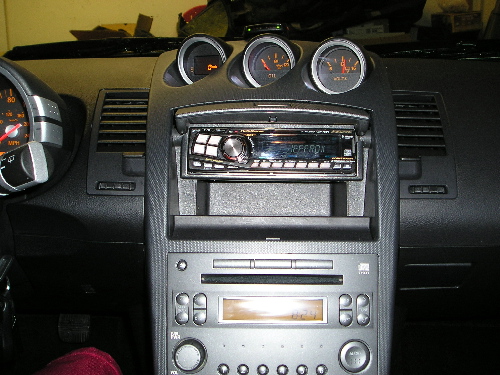

My baby is a work in progress, so I will add pics to this thread as I go.
I will explain my system when I have pictures to assist my explanations, so these pictures here will give you some ideas about what I am up to.
My goal was to make this system as stealth as possible, since I live in Los Angeles, and people here tend to help themselves to things you leave in your car.
Feel free to respond or ask questions.

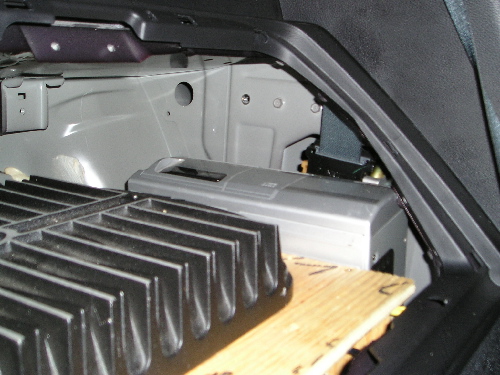

Here is where the amp, cap, distribution blocks, and changer are located- behind the drivers seat.
I ordered the bose-system grill to replace the base compartment cover to help with the cooling of the amp. The two 12-volt fans should make things perfect.

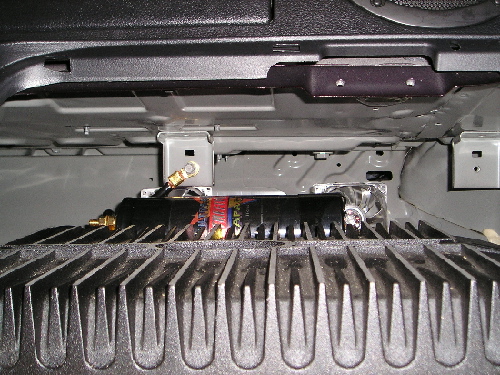

The Alpine deck has an mp3 player, so the changer will be for all of my "purchased" music.

I know what you mean about people helping themselves to your stuff...
How accessable is the radio in the NAVI space?
NissanCar
Old Jun 2, 2003 | 08:48 AM
Jeffrox's Avatar
Jeffrox
Posts: 9
From: Los Angeles
The radio just BARELY fits. The Apline face swings out from the bottom to load the disc, and it just clears the door of the NAV compartment. The door closes even with the face on the radio.
The only drawback of this installation (other than the pain-in-the-*** custom dremmeling needed) is the fact that I had to re-route the air conditioning system.
