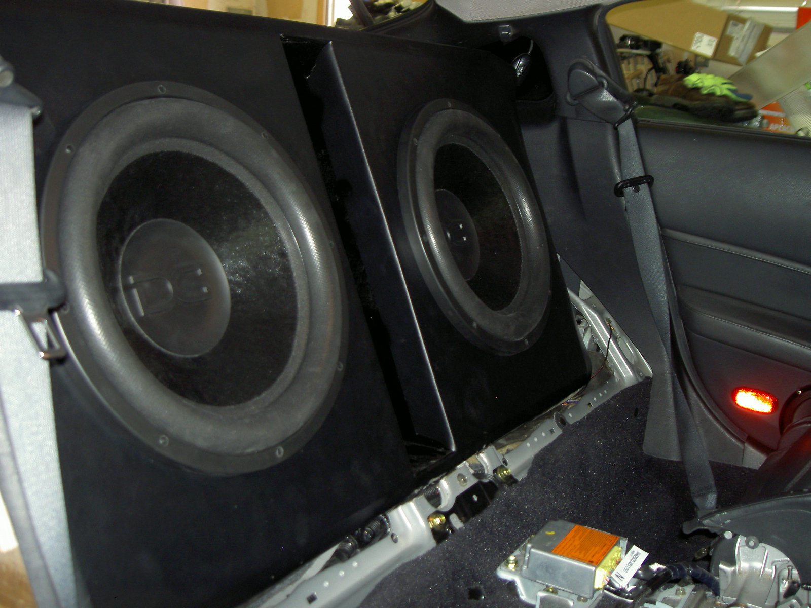

subs mounted and all wire ran back to the trunk
just need to build a beauty panel around the subs
and design an amp rack

How much space are you giving per sub before displacement? Doesn't seem like much. How much port area do you have as well? Should have just walled off the entire back . I hope you break 150 on music.
Old May 27, 2013 | 07:35 PM
wrecker's Avatar
wrecker
Joined: Mar 2010
Posts: 184
From: vancouver
3.25 Cubic Ft Each 6.00 Total
Tuned to 32 Hz
Port is 2 x 20.5 x 27.75 (Note that because the port is on the angled face the end is also angled, also they combine for a 4 inch port within the middle of the box)
Port air velocity below 30 m/s.
TFM Graph included with roll off point. posted down below
might be close to 150 db.. i will try it out.. see how she does.
i could easily get another 3.5 k hit that magic 150db..
its all fun
