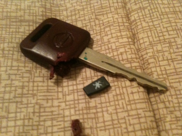

I just bought my flip key the other day but this is the only key I have that starts my car the others just unlock the doors, can I cut the transponder out of this and use it in my new flip key?

How is that the answer to my question? I asked if it could be cut out like it can on the oem key because mine is made of rubber and completely different.

Why would the outside material (rubber vs plastic) matter? What you're looking for is the transponder chip and your key has it. Move it to your new flip key, get the metal key portion cut, and it'll work.

I didn't say it was rubber because I was hoping someone that had the same key as mine, and attempted to remove the chip from it would chime in. Not someone that felt the need to try and answer a question they didn't really know the answer to. So to further clarify my originally post; could anybody please tell me if I can remove the transponder from my key without damaging it, and transfer it into my flip key.

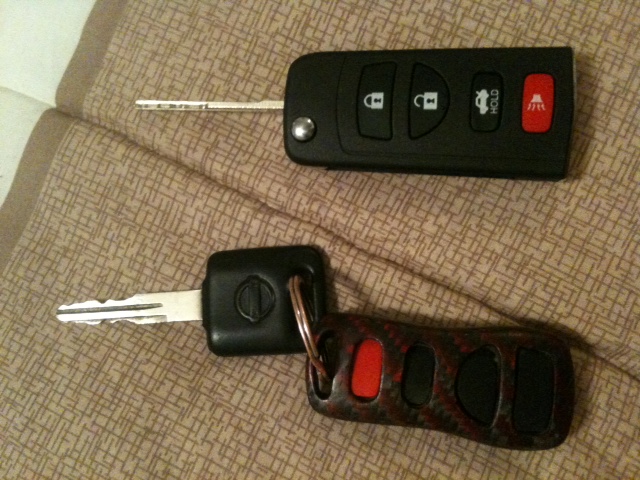

$40 thats kind of high because I only paid around $20-$25 for mine and then pulled all the stuff out of my spare remote and put it in the new one, then cut the chip out of the key and glued it in the top right of the case by the button of new key. I took mine up to nissan and they cut it for free but I also told them I ordered it from nissan LOL. Here is mine...

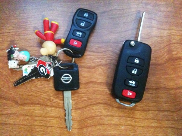

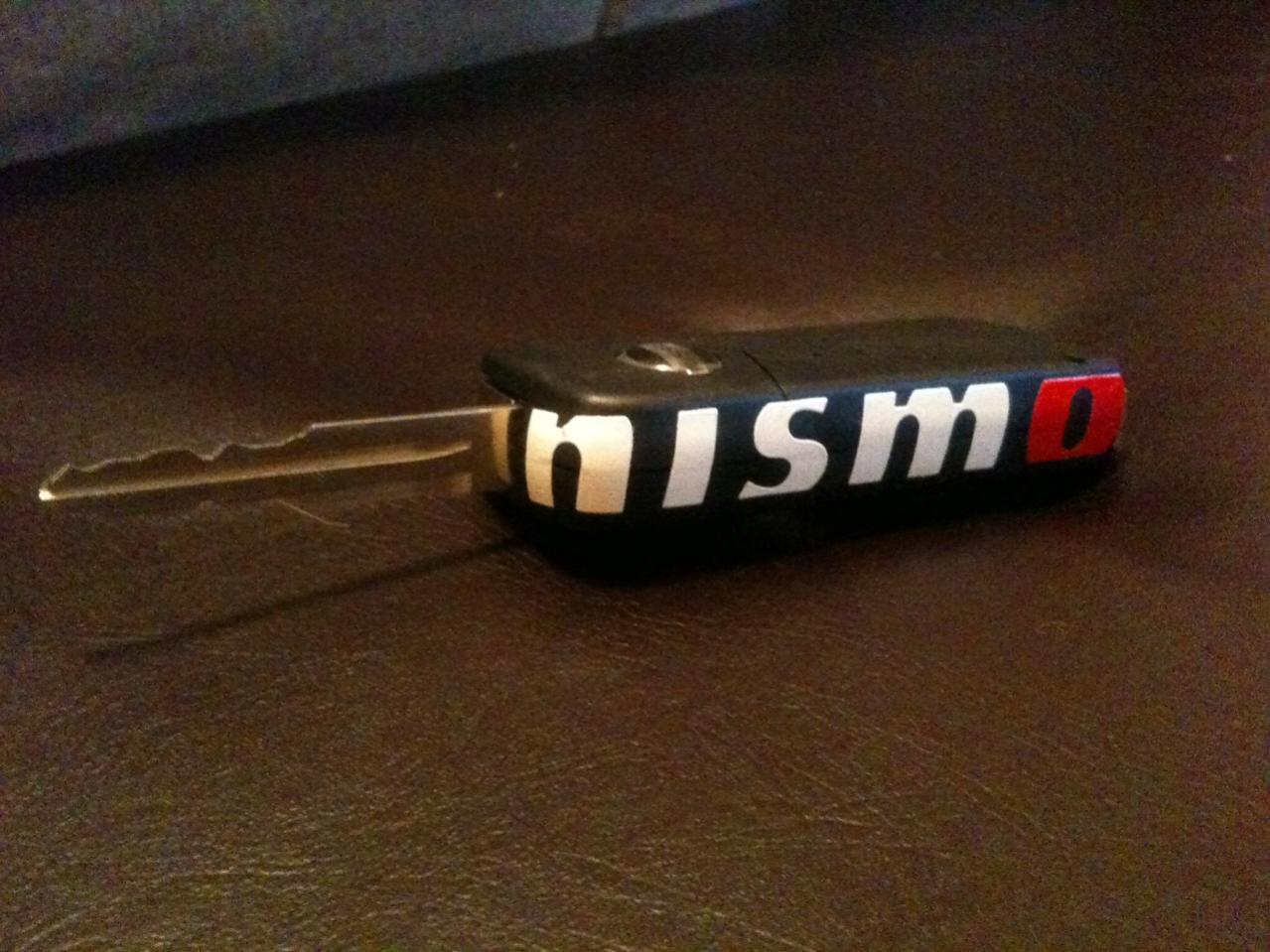

My FOB came in!!! I'v been waiting to do this, in less than 5 mins i had remotes switched, took it to Home Depot and got them to cut a key, charge was $1.98 what ever cost it took to cut any other key I didn't care. I wanted to use the key right away but the transponder hadn't been exchange so i held my original key next to Ignition and turned the new copy, BOOM.. Worked!
5mins later had it out of the Valet key and in the new..
I added the NISMO sticker bc it was collecting dust and thought it was to small for the car.. lol
Attached Thumbnails How to DIY: Switchblade Key aka Euro Style Flip Key-photo-25-.jpg   How to DIY: Switchblade Key aka Euro Style Flip Key-photo-26-.jpg   How to DIY: Switchblade Key aka Euro Style Flip Key-photo-23-.jpg
