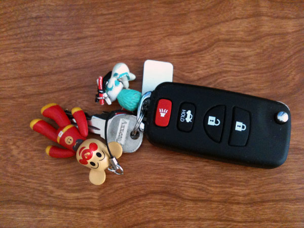

haha this thing came today and it won't fit haha don't waste your money and time on this item. http://jbrlsr.com/?aid=5336108632&bi...3D140318842954
anyone know where to get the right part?

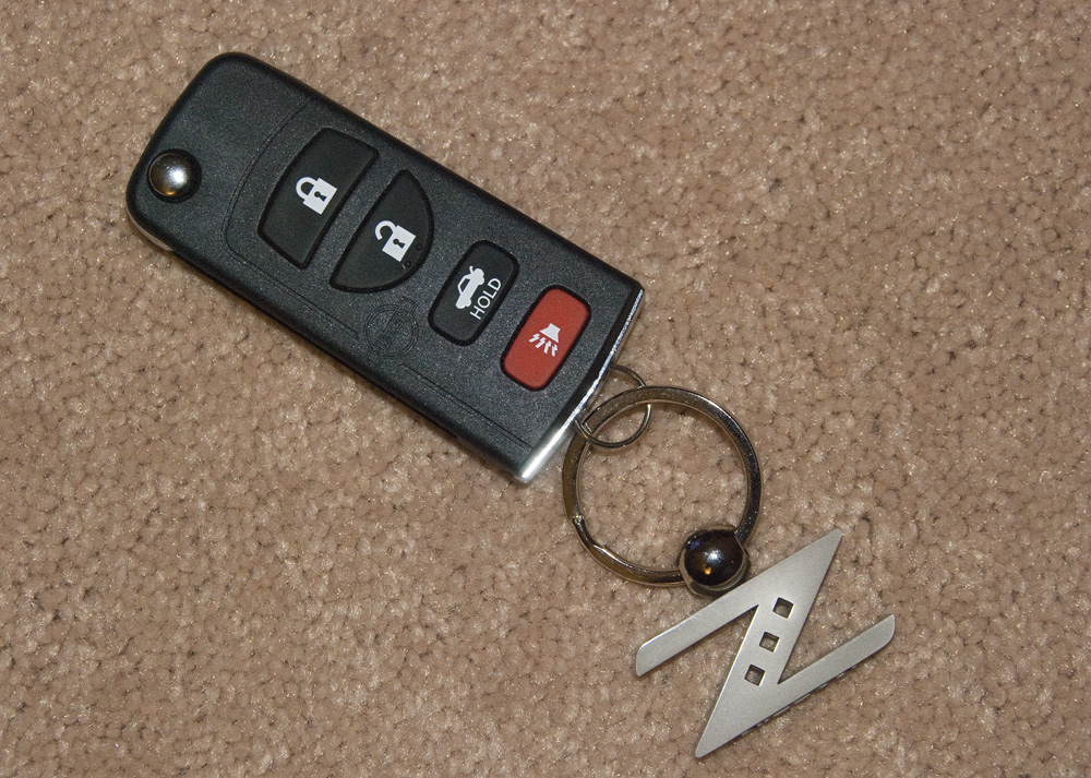

I ordered from this guy.
http://cgi.ebay.com/ebaymotors/ws/eB...0832&viewitem=
Received it within a week. Installed it tonight - straightforward with no issues. Just need to get the key cut.

I just got that same one. I love the way it looks, much nicer than the other models and slimmer. It got it together without much issue and it works perfectly, however I cannot figure out how to get a keyring in the bottom of it.
It's such an awkward shape on the bottom and holes for the keyring are so small that I can't get it through. Anyone successfully get a keyring into the bottom of that model?

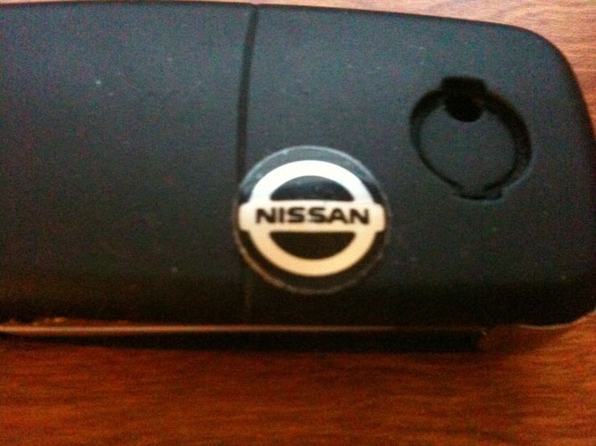

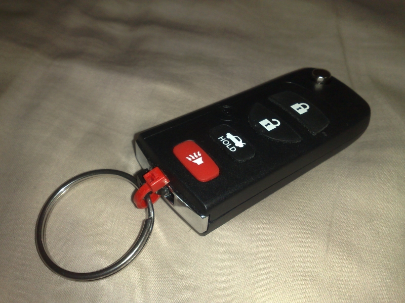

You won't be able to fit any sort of key rings in there, unless you file the plastic down or drill holes.
What I did was use 2 zip-ties, since that was the only thing I could think of that would fit in such small space without it being prone to breaking/tearing. It's kind of ghetto, but I haven't seen a better solution (I'm not holding 2 different sets of keys separately) and it works flawlessly. I used 2 zip-ties because I didn't want the metal ring to come in contact with the "chrome" surface and scratch it or something. And because of the orientations of the zip ties, the ring only bends backwards away from the rubber buttons (so I have access to them even in my pocket).
The "Z" is just from the original MY350Z.COM stickers that I added so it's not like everybody else's on here. If you don't like it, well I didn't ask for opinion. It's not that noticeable, only at certain angles or under certain lighting.
Attached Thumbnails How to DIY: Switchblade Key aka Euro Style Flip Key-11012009173.jpg   How to DIY: Switchblade Key aka Euro Style Flip Key-11012009174.jpg

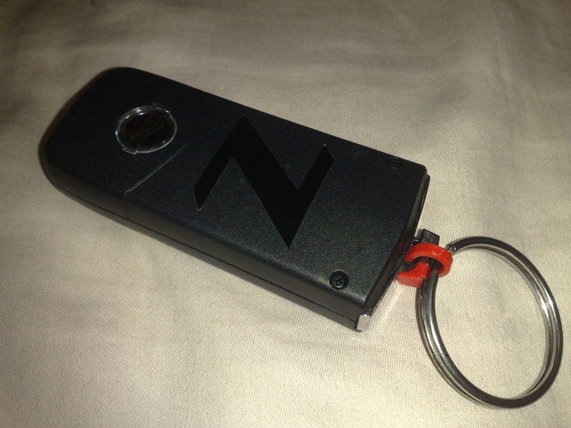

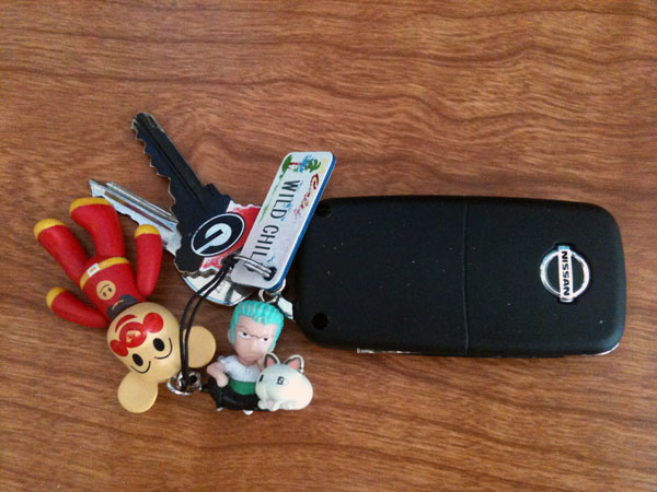

here is mine (: i hope you guys enjoy this key.
Attached Thumbnails How to DIY: Switchblade Key aka Euro Style Flip Key-img_0586.jpg   How to DIY: Switchblade Key aka Euro Style Flip Key-img_0585.jpg

Anyone have issues with the emblem sticker peeling up? mine wont stay stuck down because of the curve in the shape of the fob... one side keeps peeling up.

Same fob as in post #207 above. Actually, at closer look, it appears his emblem is creeping up on one side too.

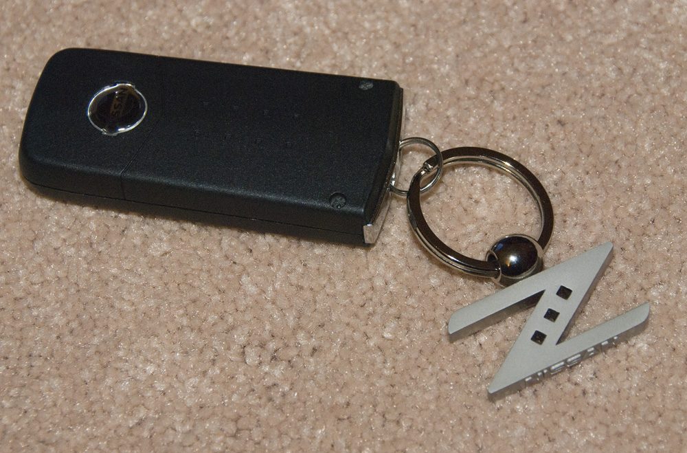

I found a small keyring which fit and then slipped a bigger keyring onto that - looks fairly good...
