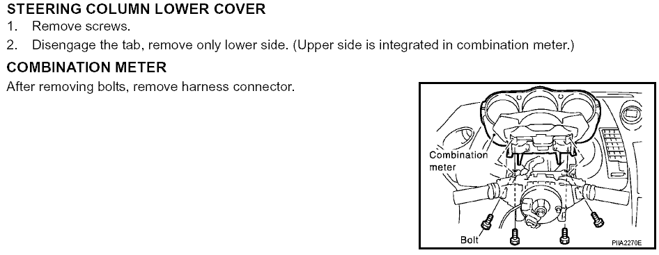

The steering column does have screws in it. From memory it has four screws quite deep in the holes.
Some of the holes do not have screws in it
Hope this helps
PS: Here is a image from the Aussie manual

That's interesting, mine is defintely different than that. I should take a photo. I was upside down with a torch, there are no screws in any of the holes, you could see through all of them.

You sure it is a 350z
I believe yours is a 03/03 build like mine so it should be the same.

hey Matt Im with you I tried today to do the same thing and i'll be buggered if I can find 4 screws, found 2 though?
Undid the 2 and still couldnt get the bottom of the steering cover thingy.

Hey Guys,
Seeing as though I couldnt make it down to Sydney today I had a spare half hour to finally sort the mic out.
There are four screws and the two back ones are very deep so you will need a long screw driver.
When your upside down looking at the underside of the steering, the screws are in the four outer holes, two at the front and two at the back.
I also took off the kick panel, but, I dont really think you need to?
I put the resistor in and now it doesnt seem to change volumn all the time but ive only been in the car for 10 mins.
H
