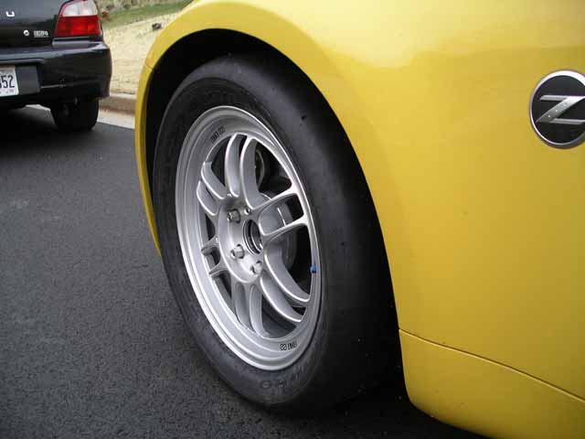

Chris I'm running enkei rpf-1s all around only problem was the 7.5"s for the fronts have a 48mm offset so in order to reach stock i'd need 18mm spacer but i also needed the extra 5mm to fit the 275 so right now wheel with spacer is 25mm offset.
The 8"s for the rear came in 35mm offset so they should be gtg. I might want a little more track in the back later with a 7mm spacer but I'm going to run it like this first and see how it works out.
for the front I made the 23mm at a machine shop and i'm really trying to get them perfect, if I can't (i've got weak metal lathe skills) ill run the 20mm spacers i bought.
Basically the enkeis where the lightest wheel that fit into my budget for the year. So i had to make them fit the car. I'm running nismo long hub bolts in the front to make them fit.

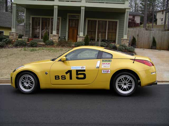

pictures
[IMG]9223.com/ebayz1.jpg[/IMG]
[IMG]9223.com/ebay/z2.jpg[/IMG]
[IMG]9223.com/ebay/z3.jpg[/IMG]

i dont know why they dont show up off my site..

fat tire

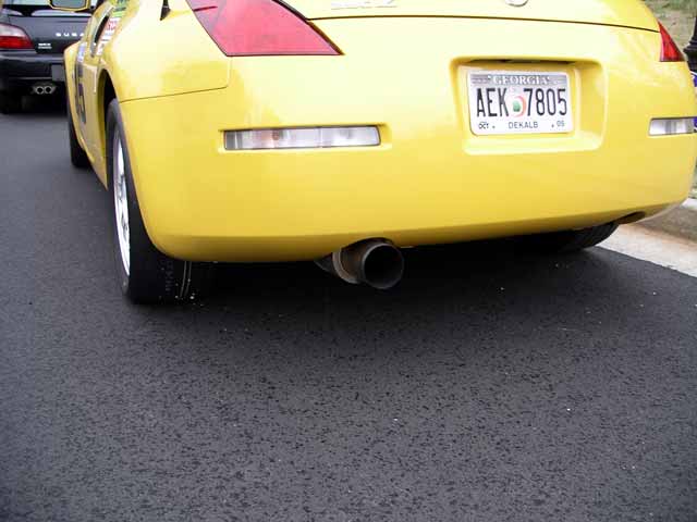

exhaust
