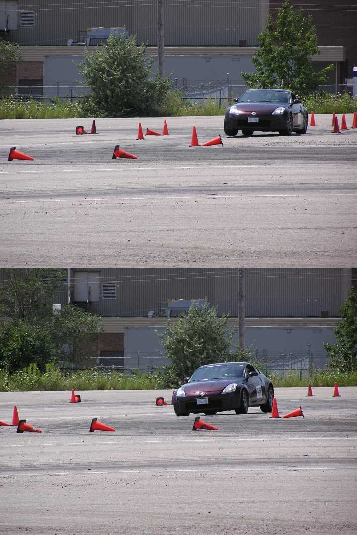

The first one shows that my Koni SA and hotchkis springs might be at their limits...
http://www.pbase.com/klin/image/64748197
http://www.pbase.com/klin/image/64748103
What spring rates are you running? From the look of the picture I would guess you need to up your spring rates by 50% all around (if the Konis are valved for it) and maybe reduce your front anti-roll bar by 1mm. Balance looks good and so does rear camber. It looks like you can put the power down well.

Hotchkis spring rates are 340/330 lbs/in f & r.
I agree with your assessment. I'd like to keep the soft springs (for the street) and run dual adjustable dampers but that's a bit of a band-aid and is also an expensive solution.
50% stiffer springs are one of the more feasible options I was considering. Perhaps 500 lbs/in f&r. Eibach has an extensive custom catalogue.
I called Koni and apparently the dampers are setup to a max of 100% more than OEM - so they can handle stiffer springs.

More pics coming in from the weekend. A buddy combined two pictures in the same area to show me first lifting the front right tire then lifting the rear left. Pretty cool.

A lot of the stiffness people feel has to do with the compression damping of the shocks, not the springs. Typical street performance shocks are designed to work with OEM or slightly stiffer springs so the compression damping is increased a lot to give the driver some initial response in transitions. That's exactly the opposite of what you want when going with 100% or more stiffer springs. When the spring rate is increased significantly then compression damping can be reduced to OEM or even softer levels because the spring has more control over the wheel in bump. Rebound damping needs to be increased significantly to control the increased spring rate in droop.
When I went from Koni SA 8610s in my 240Z to Penske TA 8760s I was able to drop the compression damping by 50% while retaing a lot more spring control. I was able to significantly increase compliance, the car stuck much better in bumpy corners, I could drive over corner curbing without upsetting the chassis, and the car rode a lot better. It was still very firm but it felt like a push over bumps instead of an impact.
