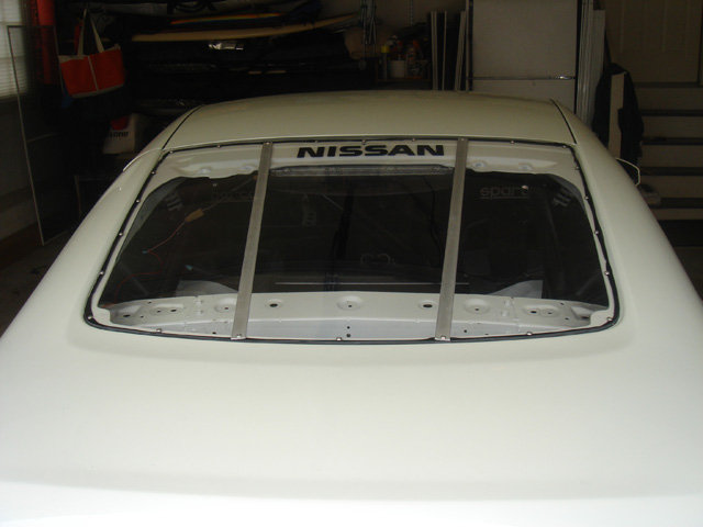

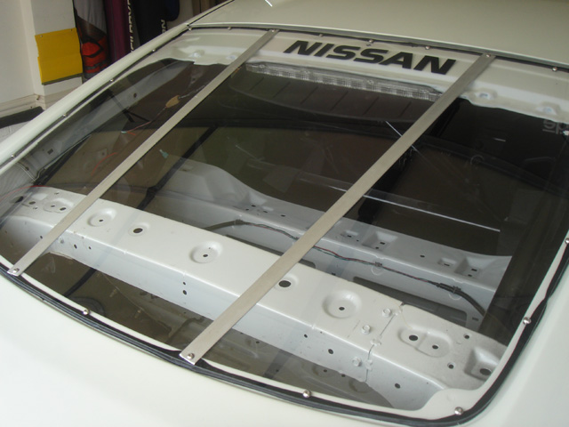

Finally got my Seibon hatch and lexan window installed. Definitely not suitable for a daily driver IMHO. Unfortunately, I did not weigh it, but it certainly feels light.
My first track day of the year is coming up later this month (Sharif's GT-R day at VIR), so hopefully it will hold up OK.

Old Feb 6, 2010 | 03:49 PM
misterniceguy's Avatar
misterniceguy
Posts: 547
From: MO
Nice. Is that on a stock hatch? Oops, just read the post instead of looking at pics. lol
