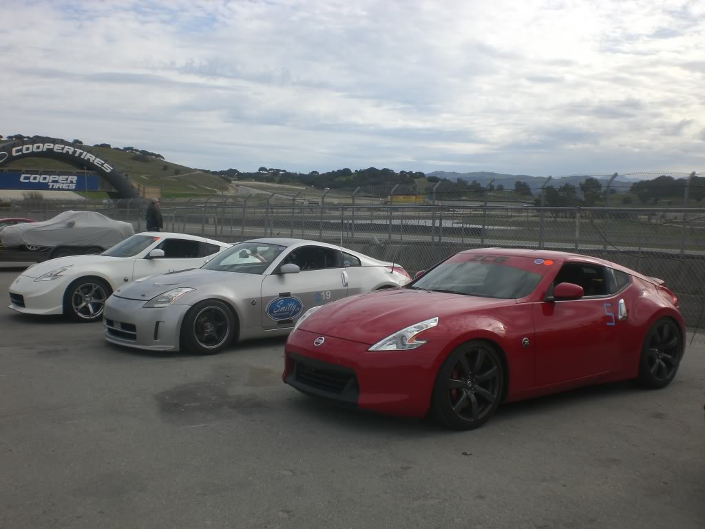

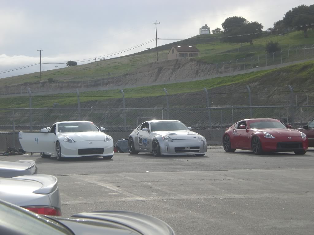

Jay,
I am just switching from 17s to 18s for BOTH my autox and track set-ups, so I have two full sets of 17s available of which I run 275 tires on. I've run both of these set-ups on my wife's stock-suspension 350ZR, so that is no issue.
17x9.5 +31 silver SSR Competitions (very light!) - no spacers needed and come with 275/40/17 Kumho V710s
I also have 17x10 +25 black with polished lip 5Zigen FN01R-C wheels with 275/40/17 Hoosier R5s. Only the biggest 275 (like this Hoosier) may need a 3-5mm shim spacer in the front. Most run these wheels and offsets with 275 tires without a spacer, but the Hoosiers are big, so I didn't want to take the chance.
I have a boatload more pictures if you're interested. Pricing would be about half of new for just the wheels, add a few 100 for the tires (which are all at about half their life and are ready to be flipped in/out). You need a higher offset to run the bigger tires in the front, especially on 9.5 or 10" wide wheels.
