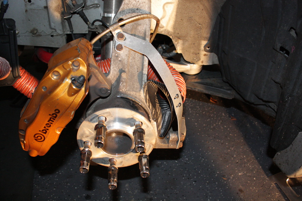

I was helping him develop the kit so the price was subsidized for me. The latest version using the fans provides cooling air directed at the caliper its self, not the rotor. (V1 was rotor cooling as traditionally seen) The idea is modern pads can take a ton of heat but the brake fluid is the limiting factor.
Kit is very well made, even though its plastic it has not melted over at least 10 track weekends. No sign of failure.
Biggest benefit so far for me, longer pad life.
Con, one fan failed due to sucking in debris. But we are running a different fan cover now with V2.
It mounts by tapping a tiny hole into the wheel bearing mounting bolt heads.
2014-05-23 18.32.02 by mhulbrock, on Flickr
Randy is very open to discussion I would recommend talking with him about your needs.
