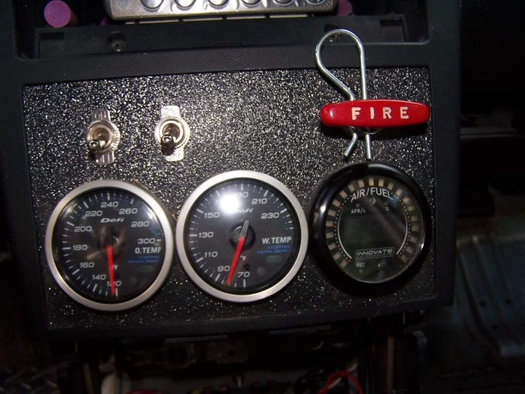

Just a note, organizations such as NASA recommend the extinguisher be in reach while strapped in for HPDE drivers, and is actually required for race cars. A fire system is on my list for next season. I would think it would be difficult to reach your extinguisher if it was on the harness bar, maybe you could mount vertically against the inside of the passenger footwell.
Heres a pic of mine:
