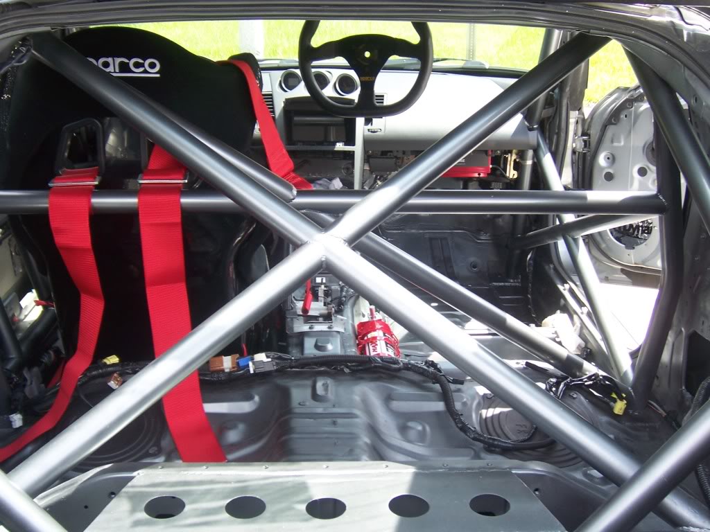

Removing the speaker box is legal. The only cage related points you may take are if you tie the cage into the pillars, and whether you go through the firewall to make it an 8pt.

Excellent, I appreciate it! Fabricator is quoting me 5hrs labor to take out the speaker box and clean up all the spot welds. I will probably have him do it unless I hear some good reason otherwise.
Budget of this part of the build just keeps getting bigger and bigger of course! lol
Yea it took my guy quite a bit of time since I wanted all the spot welds cleaned and touched up. Its definately worth it...its a pretty good chunk of weight, and really sets off the beauty of a Z racecar. I dont know for sure, but we when we cut out the rear strut and speakbox, I think it was about 50lbs, at thats what he told me. Here is a pic of mine:

Pics from the fabricator
