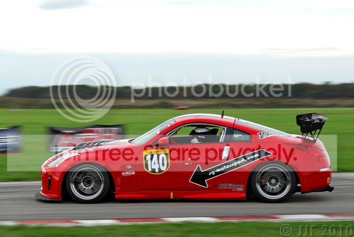

Hey Guys,
I just realized I hadn't posted any of our 2010 videos on the site here! I think a few of you might enjoy them. A quick breakdown on the car would be in order for anyone unfamiliar, so I'll try to do it in 20 words or less:
Stock body, built engine, stock heads, stock gearbox, 338whp, 18x10.5" with 280/650/18 slicks. APR GTC-300 wing and SG-Motorsport front splitter. SPL arms and spherical bushings all around, big spring rates!
We're running about 4 seconds off of the World Challenge GT cars, which have significantly more power, but are forced to run on an R-Compound. The goal next year is to close that gap, which would be quite the feat, considering they are all wide body/sequential gearbox nutty big power racecars!

Wow, car is a beast and nice driving. You were passing cars at the begining with ease..

Wow, damn, awesome driving. The car is so damn fast! Seems like it requires 110% focus and VERY quick hands to drive it and not die. Your shifts are blazing quick.
