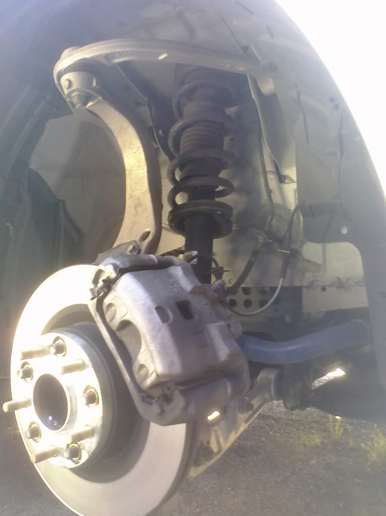

Update: Before and after pics, because when I was searching I couldn't find any proof that this would actually work.
OEM shocks w/ RSR springs:

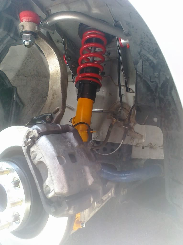

Koni Sports with 500# Tom's springs (and Kinetix UCAs):
They're at about stock height as pictured, but I'm going to lower them another 3/4" or so when I get some time. For the record, the springs are 7" long with 2.5" inner diameter.

Old Jan 27, 2013 | 05:48 AM
350z-Na's Avatar
350z-Na
Joined: Nov 2008
Posts: 243
From: Canada, QC
did you go with the same setup in the rear? specs of the rear spring please if possible. I know it's an old thread
Old Jan 27, 2013 | 11:01 AM
jarrodh77's Avatar
jarrodh77
iTrader: (20)
Joined: Apr 2010
Posts: 469
From: Nashville, TN
I think at the time I had either Cobb or RSR-ti rear springs. I later ended up going with coilovers, and the car is now back to stock and for sale.
Old Jan 27, 2013 | 11:03 AM
mw9's Avatar
mw9
iTrader: (51)
Joined: Oct 2006
Posts: 2,405
From: cincinnati
in for updates
does this give you the ability to corner balance car?
Old Jan 28, 2013 | 04:55 PM
jarrodh77's Avatar
jarrodh77
iTrader: (20)
Joined: Apr 2010
Posts: 469
From: Nashville, TN
They're height adjustable, so yes you can corner balance. I would suggest grinding down the edges of the round metal piece in the center of the tophats if you're going to reuse the stock tophats. Mine were a little noisy at times, but if you just shaved a couple mm off, the springs wouldn't rub. Helper springs would be ideal if you can figure out a way to do it, because my springs would fully unload under droop once I went any lower than the picture above.
