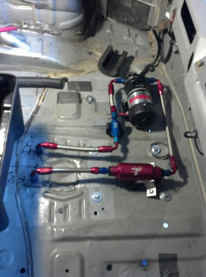

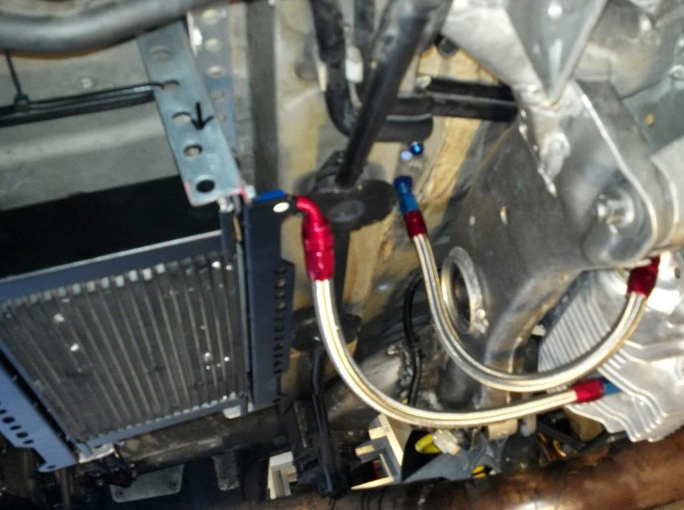

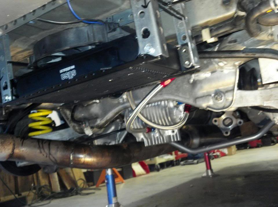

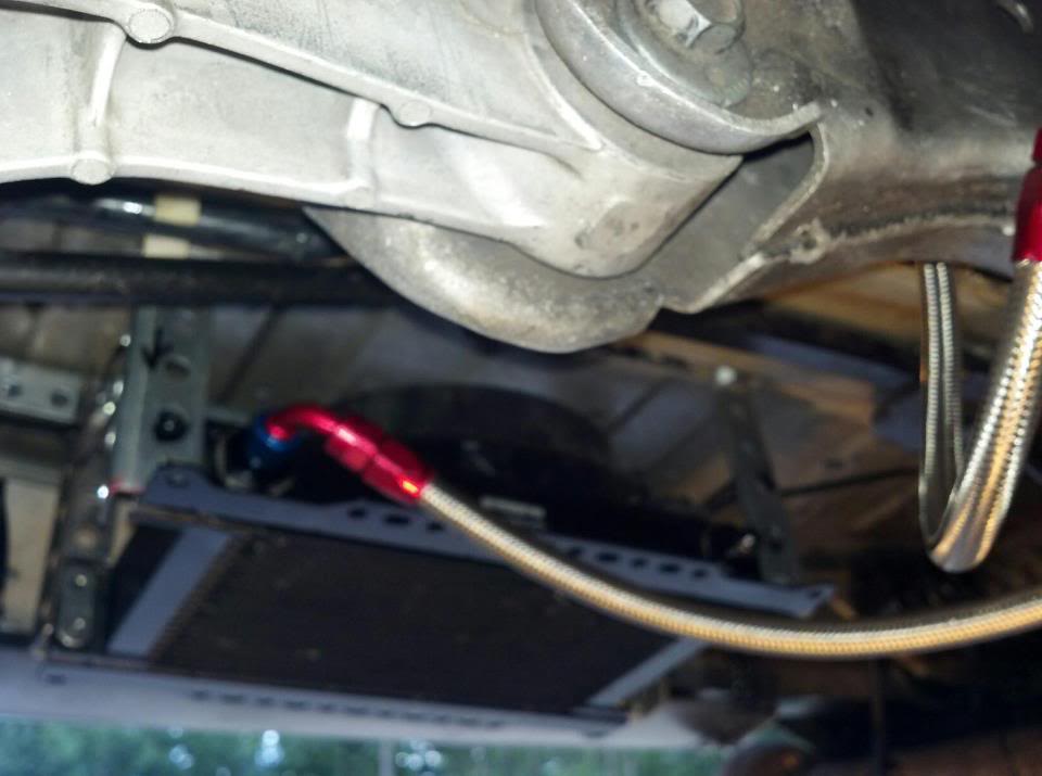

Diff cooler roughed-in, using used left over stuff...hope it works. But most of the hard work is done. Need to finish the hardware install , then wire the pump and sucker fan up to a manual switch...more to follow...
Blue thingy is a check valve so oil will not drain back to the diff
Red thingy is a oil filter
Sucker fan mounted to the top of the oil cooler
