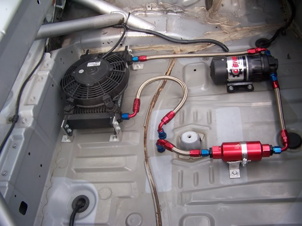

Installing diff cooler to help the Wavetrac make it thru the season...a real PIA..but worth it I suppose...

Who makes it? Got pics?

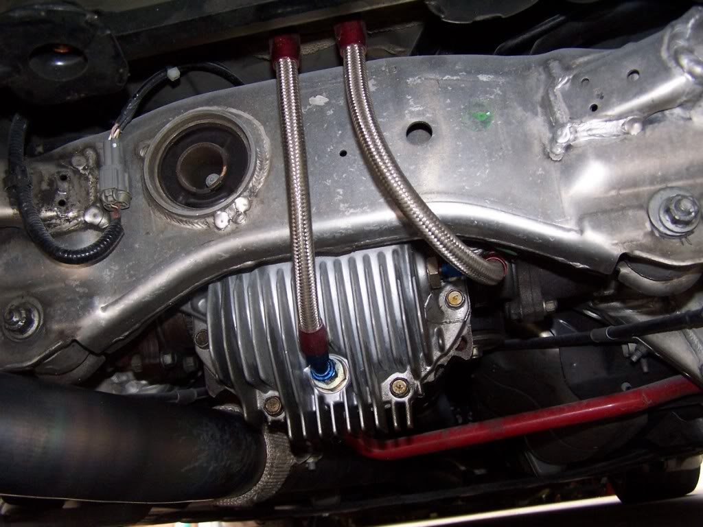

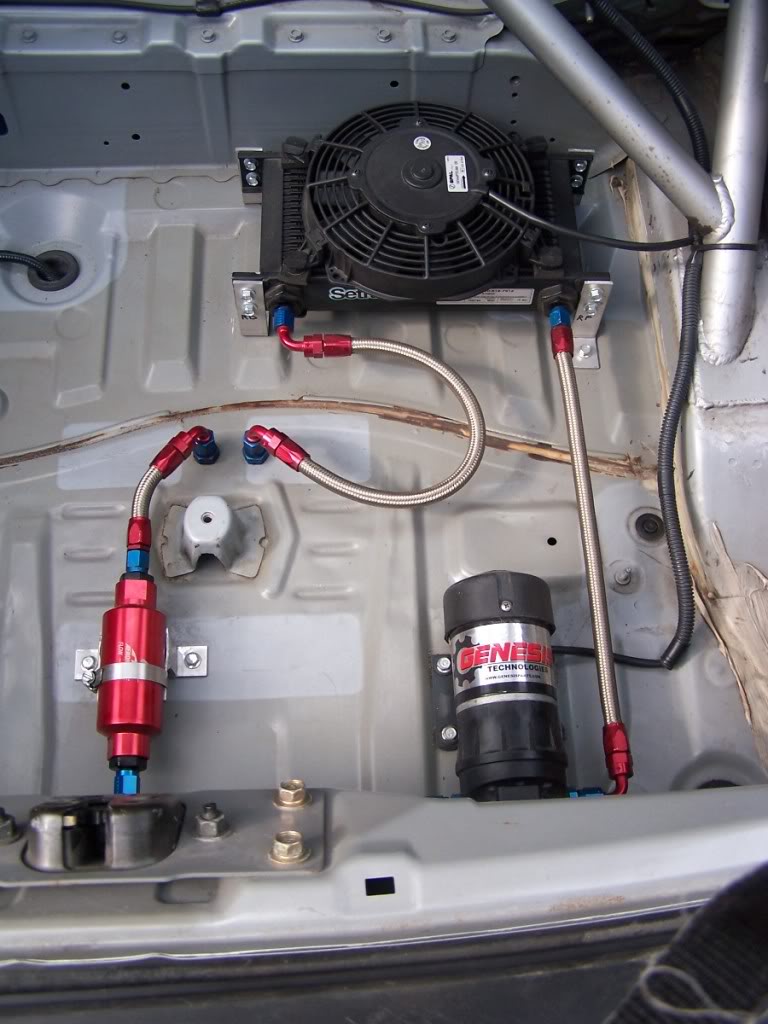

Don't know...the stuff came on the car when I purchased it. But I removed it as it was leaking from the pump...that I rebuilt yesterday. Looks like it was missing a O-ring from the factory
I am not installing in the same configuration as it was...so it will take a little while...but pics to follow..I am moving the cooler and fan under the car...this should lower the heat level inside the car...the pump and maybe the filter will be the only thing inside the car.
this is what it looked like before:

What size line is to the cooler , looks like -6 , and why didnt you keep the cooler under the car in the oil flow?

I think they are -8.
And the pics you see are how the cooler was set up when I purchased it, but removed because it leaked from the pump so I never ran it that way.I plan to move as much hardware under the car to Diff level that I can.
