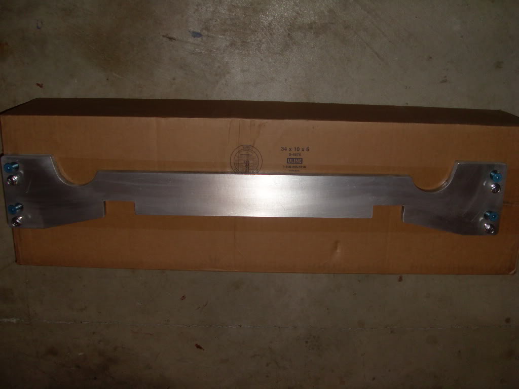

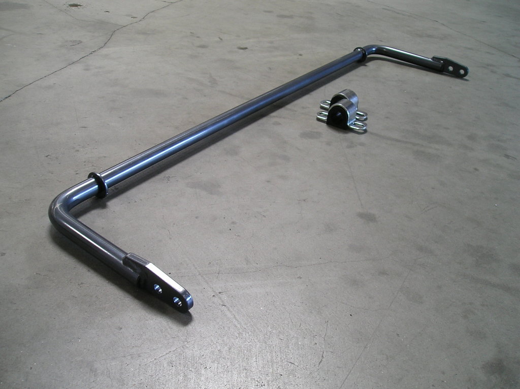

so i am going to Sebring in about a month for my next track day with Chin Motorsports and have some questions..
i am driving my Caliber Srt-4 in the event(sorry Z has been gone for 2yrs now) and after last event i decided i needed to work on the suspension(obvious shortcoming of the car) from what i have researched and reviewed i have found out many people feel the rear sway bar is too weak and too small for aggressive driving and promotes more body roll and understeer. i have also heard that once you purchase an upgraded bar the
holes in the rear subframe will tear/crack under hard driving. I also found the company that offers the upgraded rear sway bar makes some beefed up tie bars for the rear end.
i included some pics of the items mentioned and was curious of some honest opinions about what i can expect in regards to handling gains or losses.

Rear swaybar increase in thickness will help to reduce the understeer so it should help the handling issues.
Not sure about the big plate. Looks like it is designed to distribute the force to the plate but can't tell how well it will work and/or if it relocates the sway bar in way that might change how effective it is.

i have a feeling the caliber pushes like crazy. if so, a rear sway is a step in the right direction. i've raced showroom stock where you have to really get tricky to get the fwd cars to rotate because you're not allowed to add modifications.
these are more suited for a dedicated track car, not a DD. but try a bit of toe out in the rear, like 1/8". if it feels comfortable and you have good car control skills, bump it up to 1/4". i've gone up to an inch, ha, but that's crazy. also, a quick and easy way to rotate is put about 50-60 lbs of air pressure in the rears. increasing rear pressure will actually increase grip, to a point. you gotta get over that point. i've gone up to 70. again not recommended. but a racer gotta do what a racer gotta do.

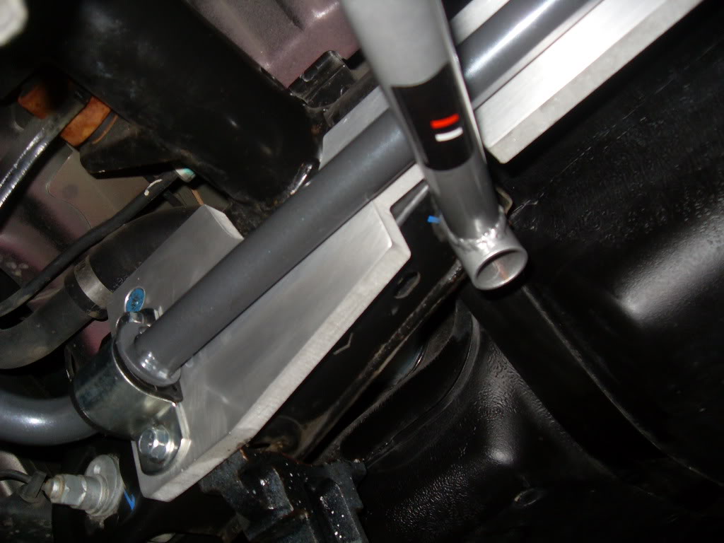

holy neutral handling batman! i got the new parts installed friday night and what a difference, turn in is sharp and easy, general steering effort is also
improved, corners like it should now. i also noticed some other benefits that were not mentioned by others before: almost no fwd torque steer under full throttle all the way up to 80-90 mph, much less throttle bobble taking off from a stop or during gear changes(noticeable in fwd cars with transaxle), also reduced vibration in the car from reduced chassis flex.
my track day is this sunday, pray for good weather so i can feel the full potential of my upgrades.
i am going back again in November, will have next upgrade installed by then, should put me around 450hp/400 tq at the crank with pump gas,
slightly higher when i add my track fuel additive mixture(tuolene/trans fluid/mineral spirits)now with the improved handling the added hp and tq will be usable-if i would have added that first it would have been a waste.
