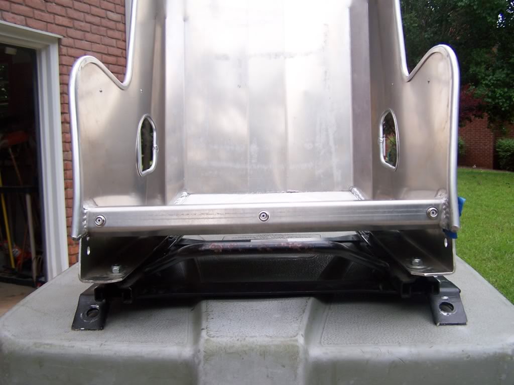

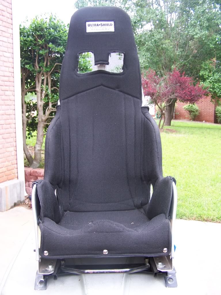

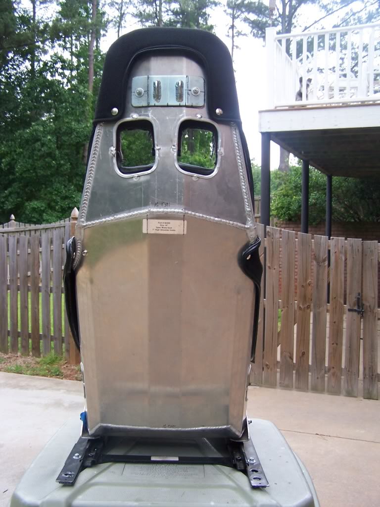

I copied this from one of my post in another seat thread. II want to illsutrate all the parts it takes to install an aftermartet seat in a street car like you have described.
1. seat
2. seat side mounts (connects seat to base of your choice)
3. sliders (connects side mounts to base...these are optional)
4. base mount (sliders connect to base mount that mount to the floor stock mount in a street car)
Pics below for illustration only:
I ran this seat for a long time in TT & HPDE with a Harness bar...so I am not sure how this will work with OEM belts. I believe this is the UltraSheild "Spec Miata" model. I believe I used Sparco double locking sliders on a aftermarket base...This is where I purchased the seat base.. http://www.wedgeengineering.net/
Note: I ran this seat all the time...street and track and loved it...
