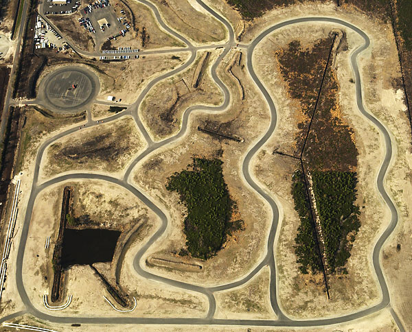

As my interests in cars grew so did my interests in Motorsports. So I signed up for an open track day at the Blackwater facility..I was hooked. Track layout below
