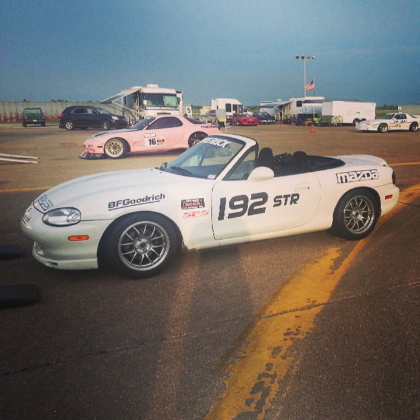

A little about me and my background. I've been around miatas since I can remember, so naturally I've had a few in various forms. My most recent is a 99 sport, originally prepped for STR.
It had a good run in STR, few national tour/prosolo wins and a dozen or more trophies. Making it the most successful NB in STR

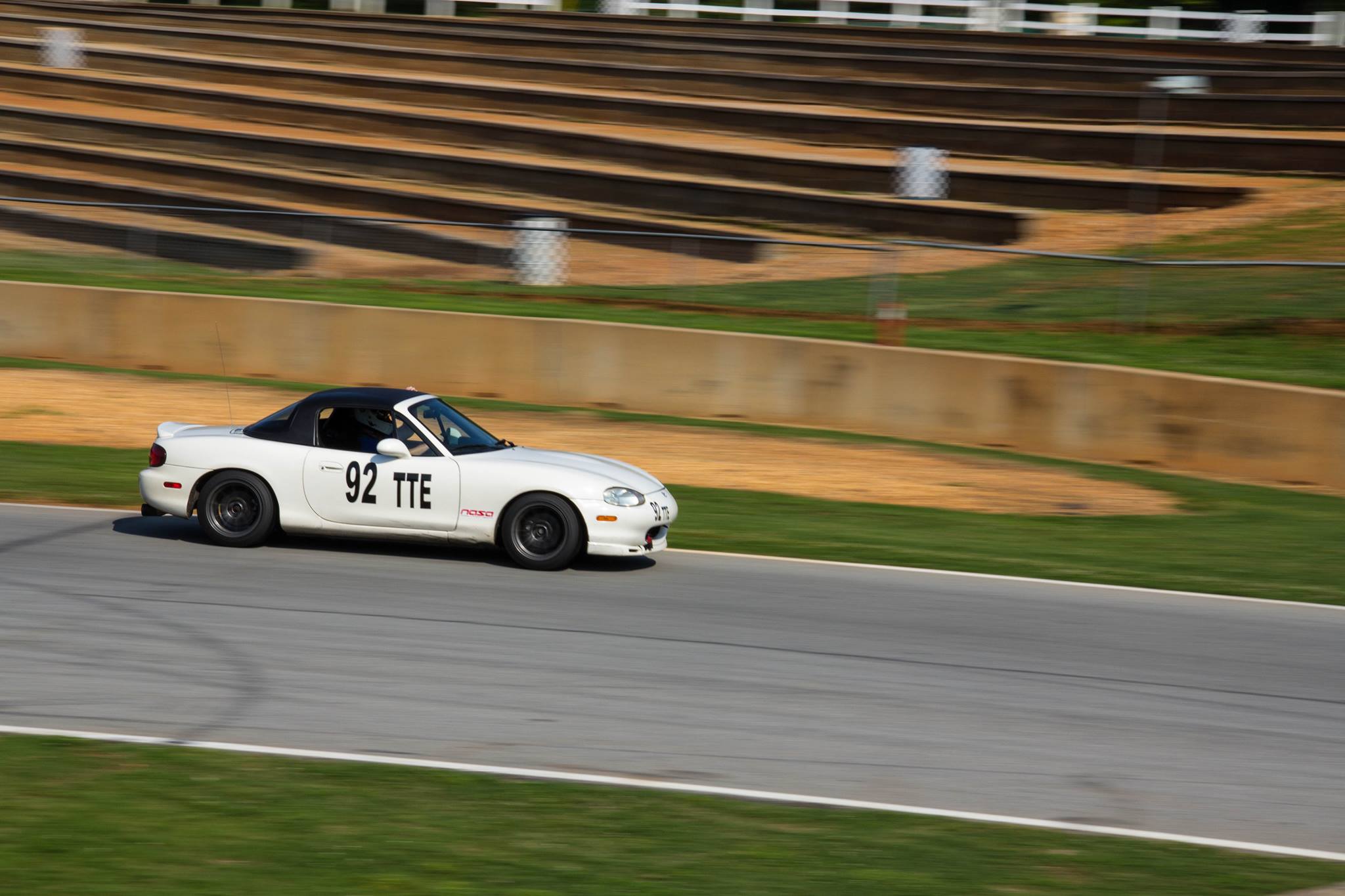

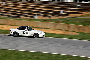

Then I decided I wanted to get out on the track, so I've prepped it for TTE with NASA. Got my TT license this year and I've been having a lot of fun with it. Never the less, I've missed going to national tours..... particularly in my own car

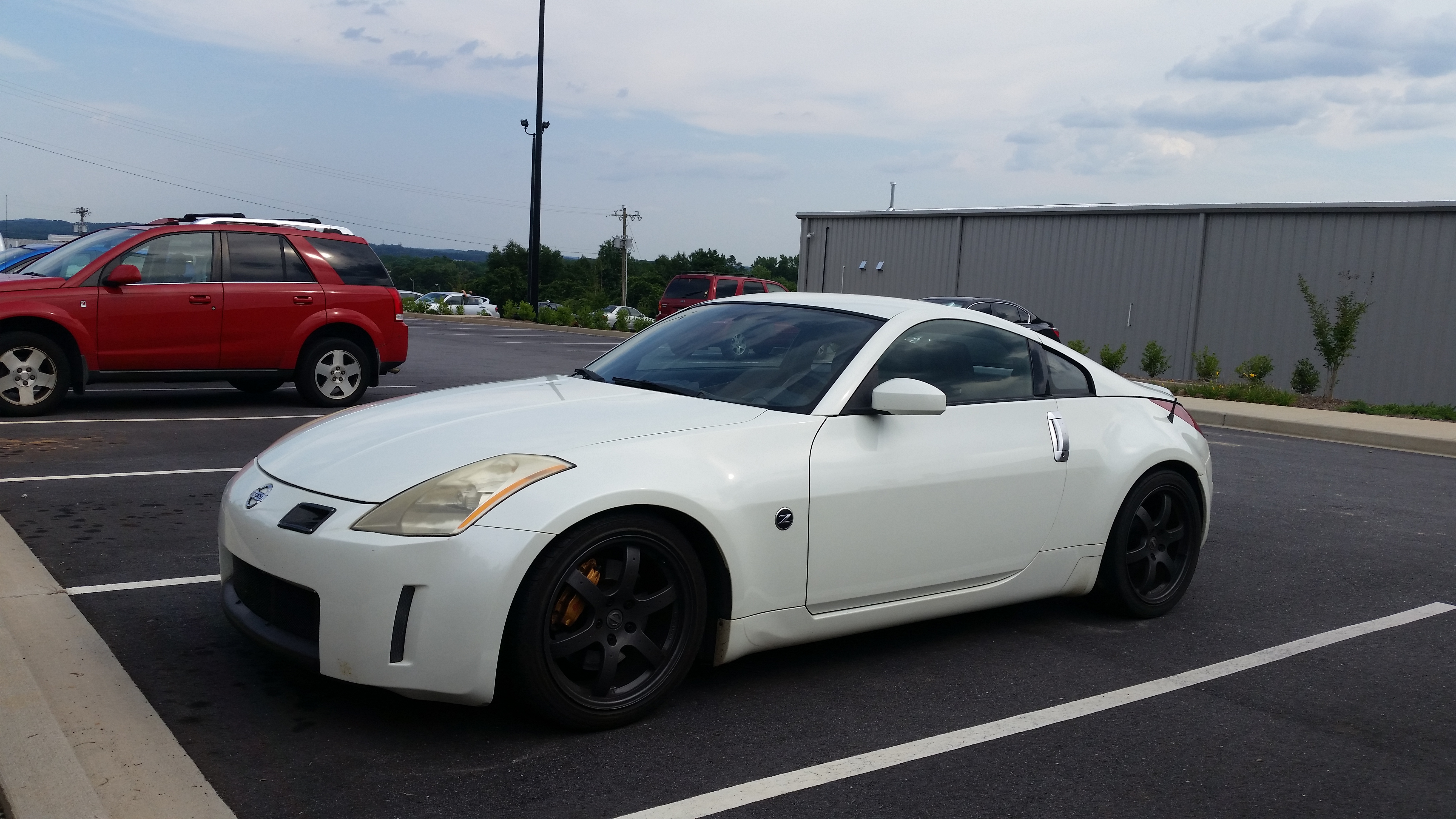

Enough with the hair-dresser's car, let's get to the Z!

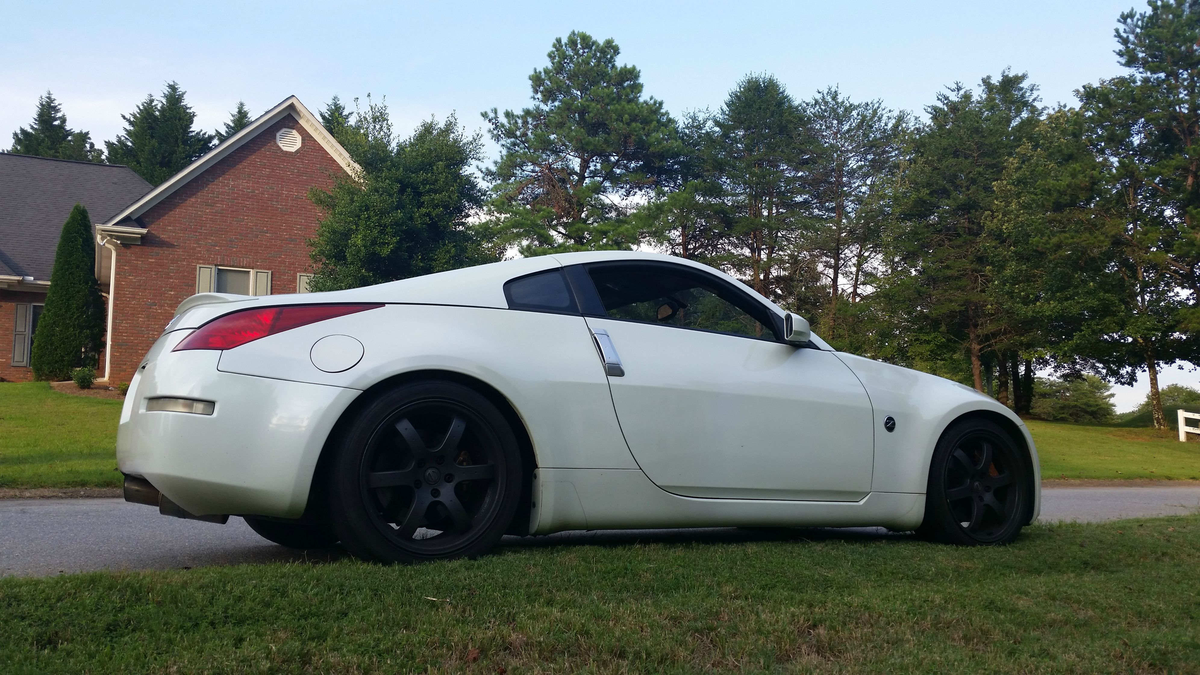

I've liked Zs ever since one of my best friends got one back in 06. Only recently has it been a possibility, mainly because they've got closer and closer to miata-pricing.
