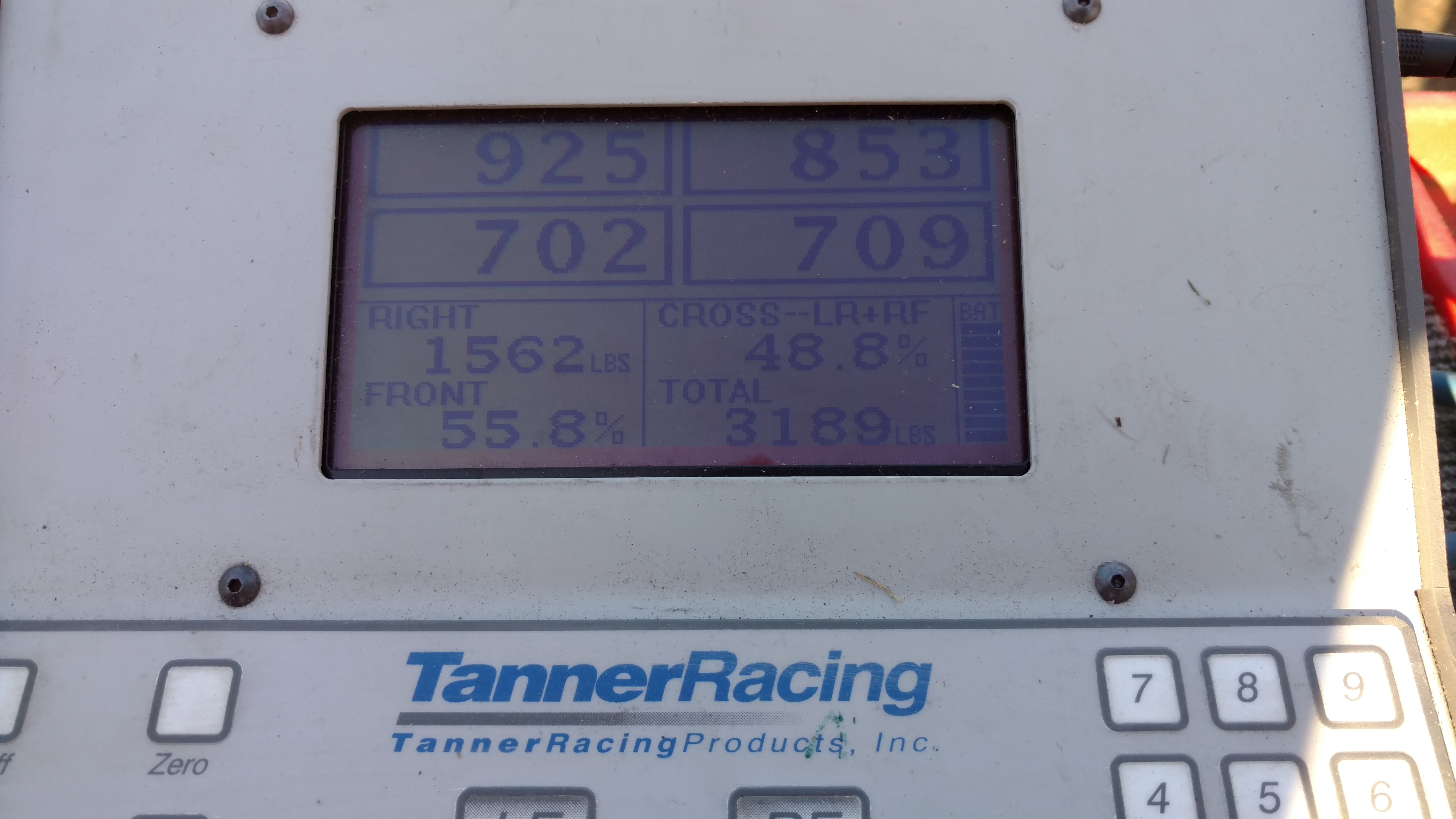

So I borrowed some scales to corner-balance the miata and I decided to put the Z on them. Pleasantly surprised with the numbers! This was with the stock track wheels 18x8/18x8.5 with 225s front/245s rear, no spare, and 2/3 to 3/4 tank of gas (70-80lbs of fuel?). Ignore the cross-weight, it was on a slight slope.
So I can drop another 50lbs easy, since I still have stock battery, stock seats, steel bodied shocks, 1 piece rotors, and functioning A/C which I'll probably keep I figure the 275s/285s will add some weight, but pretty confident that I could hit 3050lbs with a couple gallons of gas in full STU trim.
Is this with or without you in the car? (Mine was 3144 with a little under half a tank of gas and no driver)
Without a driver.

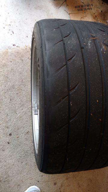

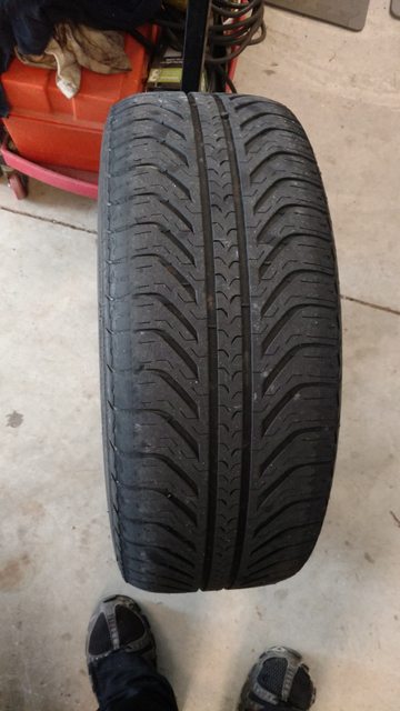

From: Knoxville, TN
Sooo, having some front toe issues...
This wear is on the inside of the tire, front only.
DD tires:
RS3s:
Control arm bushings have recently been replaced, balljoints have been recently replaced, alignment was a few months ago and the front was set to 0.
Based on this I'm thinking tie-rod ends since they are original. Or hub bearings, but there's no play in them.
Plz assist this Z nub, thanks!

What about the compression rod bushing? (And did you replace iners and outers on the control arms?
Yes to inners and outers, double checking on the compression rod bushing.
edit: Comp rod bushing was replaced but the ball-joint is not serviceable? Looking into that or maybe one of you kind gentlemen will answer before I figure it out :-D
