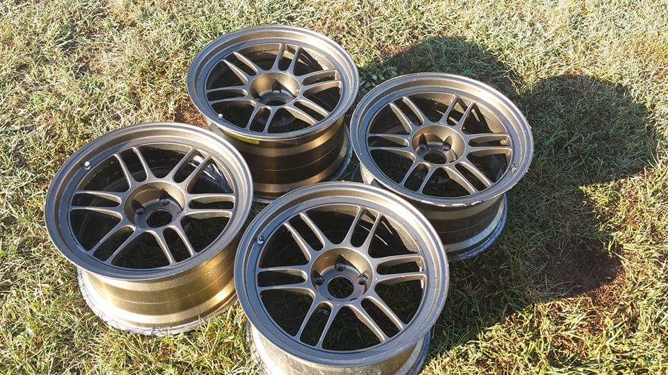

Also, I've found some wheels locally. I just can't decide how they'll look on my white car.
These are the spec STU Z wheel, 18x10.5 RPF1 +15. I can't find any pictures of this bronze on a white Z, but I think it'll look alright. Worst case I can dip them. Thoughts?

I have not seen those on a white Z but one of the guys I race with locally had gold wheels on his white Z and looked pretty good.
As far as the wheels themselves....pretty much "spec STU Z" like you said. lol

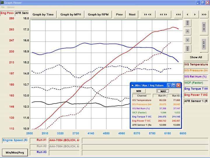

Also was wondering where the power would be after ditching the spacer and putting HFCs on the car. For a "base-line" I asked the PO for the dyno-sheet...... holy **** did the UPRev tune do wonders for this car......dotted line was pre-tune stock ecu, solid line is post-tune with UPRev
That was on a mustang dyno too. Engine seems healthy enough, I may not worry about the tune lol.

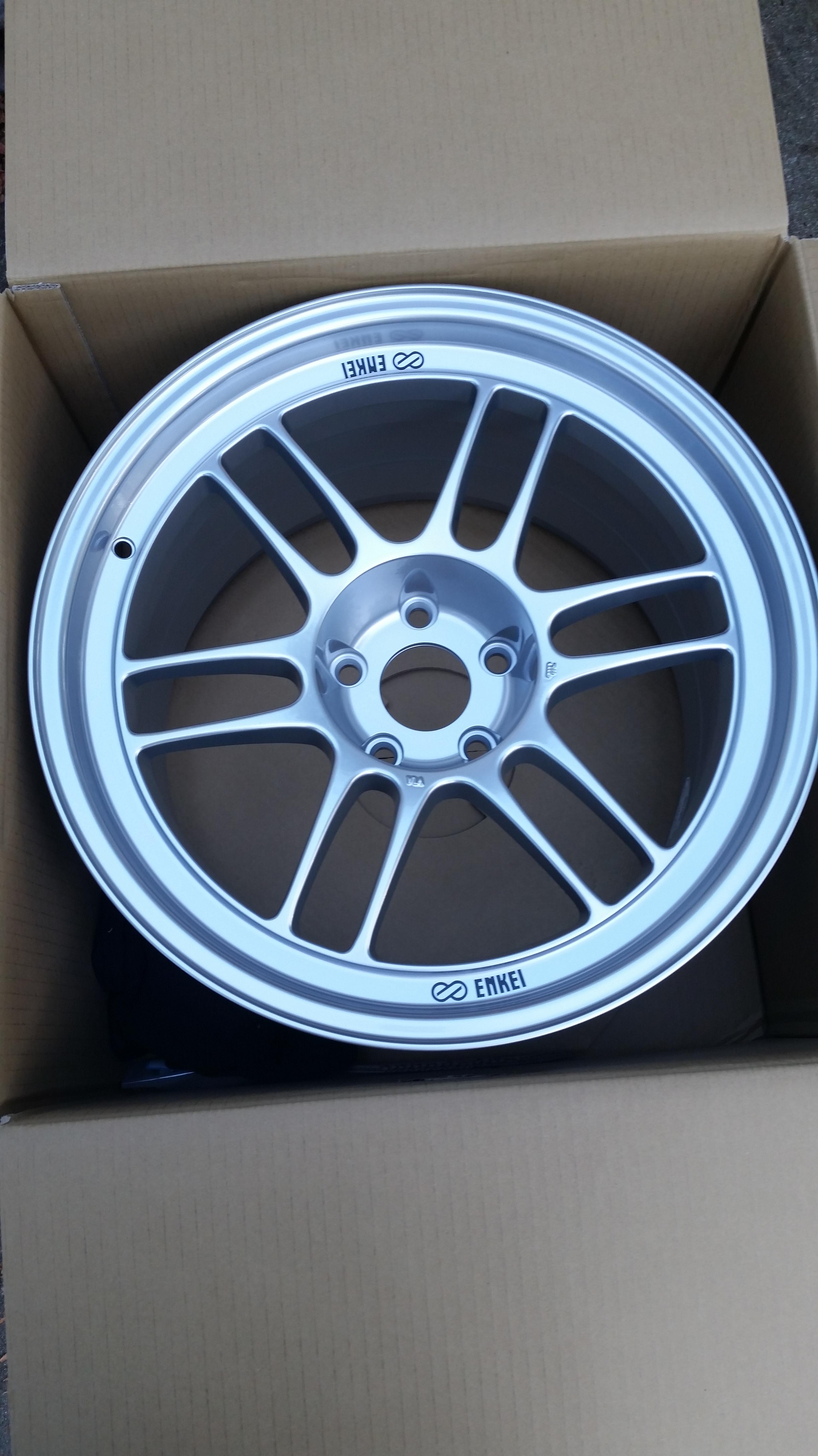

So I ended up just buying some new RPF1s in silver, mounting them up tonight, they guna look gewwd!

The bronze wheels? I didn't buy them, I think he sold them on eBay though. They had a tiny crack on the lip(where the bead meets it) that kept me away. The seller is a buddy of mine, so he let me know about it since he knew I'd be pretty hard on the wheels.

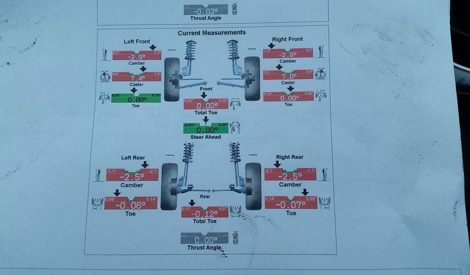

Got the car aligned..
Wanted more camber up front, but that's the most he could get. No toe in the front, I've always ran 0 toe in all my cars and I feel like front toe settings is almost a personal preference. Happy with the caster numbers, but maybe Zs always have a lot of caster with the mcphersion strut setup?
Set some rear toe to help put the power down and -2.5 camber is actually more than I asked for, but close enough.
Looking forward to the autox this weekend! I'll report back with video and such.

YOUR ALIGNMENT WILL DESTROY YOUR TIRES!!!!
Firestone...?
I've always run 0 toe, but again, I like to help my tires last on the road.
