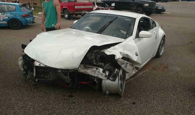

Went to Grid Life at Road Atlanta back in August. Ran a 1:42.6xx with an opt of 1:40.8 in the 3rd practice session on Friday. Well..... I went out on the last session of the day and I ran out of talent and grip in turn 4. Slammed into a the concrete wall at around ~80mph

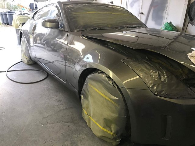

It sucked, but thankfully I'm ok and already have plans started for STU next season. My usual co-driver decided to buy an inexpensive stock Z and buy all my parts for relatively cheap. Ended up with this car, needs some TLC for sure:
Even though my wreck was pretty damn bad, got lucky on the reusable parts. It's easier to list off the BAD things from my build:
-Hi-flow cats got dented pretty damn bad, breaking the honeycomb structure loose. (trashing these)
-Passenger side header slammed into a 10-12mm bolt head, possibly salvageable
-AC compressor mounting holes on the timing-chain cover snapped off.(probably replacing the covers on my engine.)
-The front of crank pulley got chipped away from the radiator contacting it.
-Transmission got hit by the same bigass rock the cats got hit with, large dent/hole in it. (this is trashed)
-Obviously the frame and body work, along with the two front wheels, airbags, driver's seat, tires, etc.
All in all, pretty lucky being able keep most of the STU parts.... Shocks/springs, OSG, exhaust, ECU, etc.

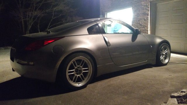

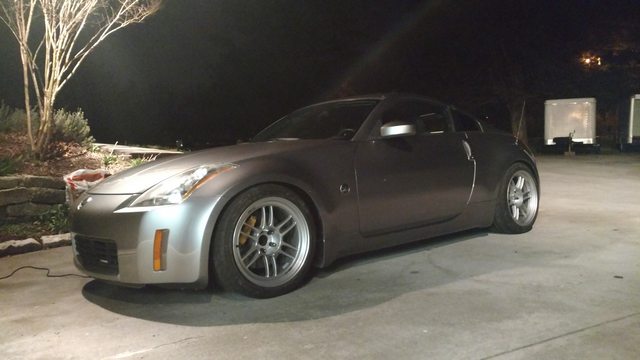

It's like I painted my old car silver!
A few more things to button up on it, then doing a local autox this Sunday. The car has the same suspension as before Koni SA 550/450 Hotchkiss f/r, kinda old RE71Rs, stock headers/cats, my old cat-back setup, my uprev reflashed ECU, brembos/dtc60s, and of course the OSG.
