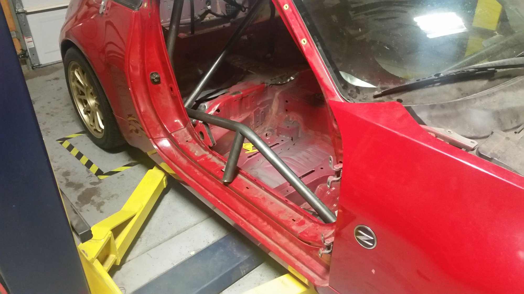

Bottom half of x brace with a rocker panel tie in... x brace has an outward angle for better impact protection.

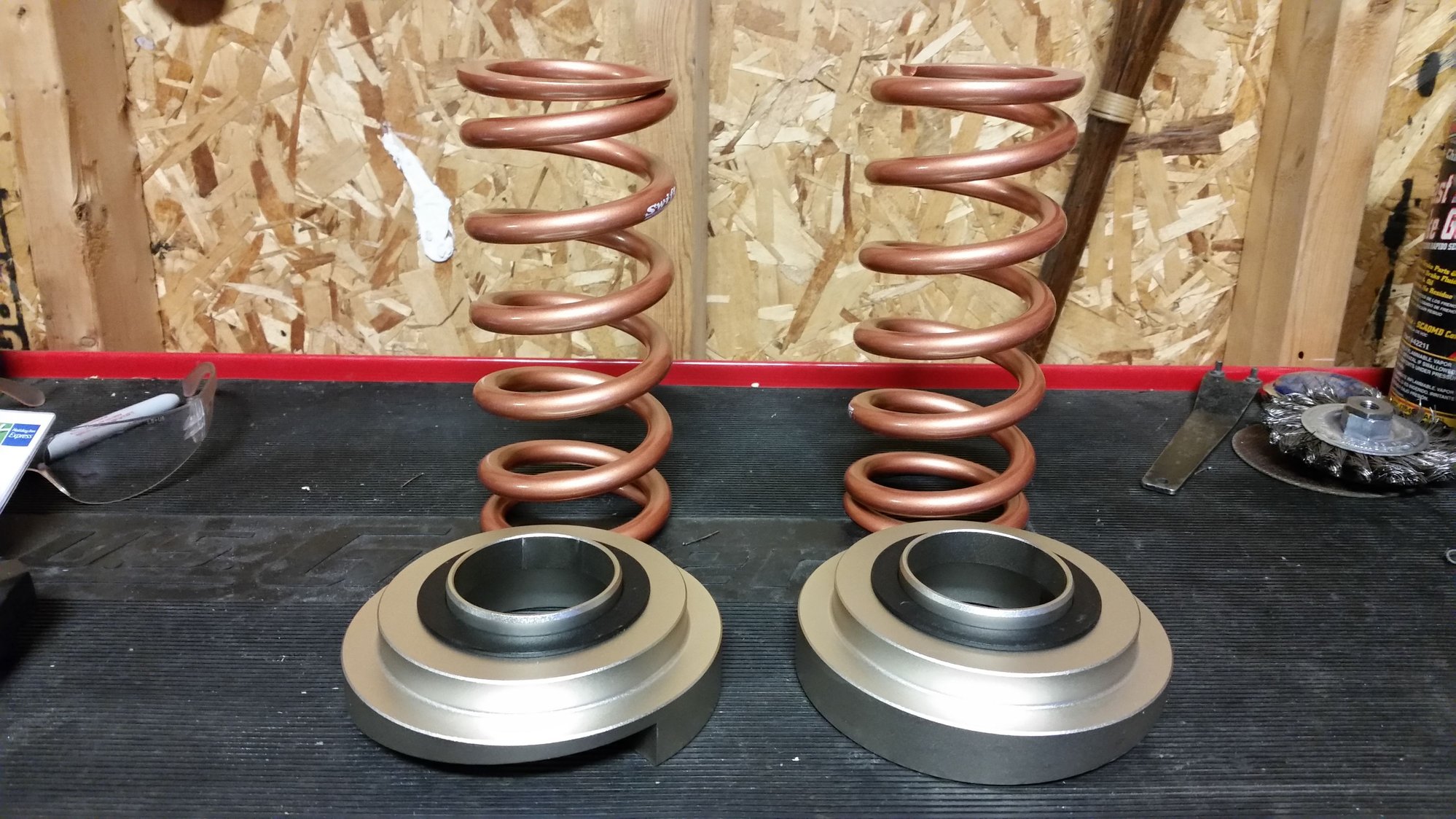

Some shinny parts:

Originally Posted by Dblock55
Some shinny parts:
Swift springs?

Originally Posted by 90nissanS13
Swift springs?
yes sir
yes sir
Part of me envies your decision.
Decision to go with swift springs or go full racecar?
Well when you put it like that lol....
The swift springs for sure. Im looking at Fortune auto dampers with Swift springs for my 240sx build.
