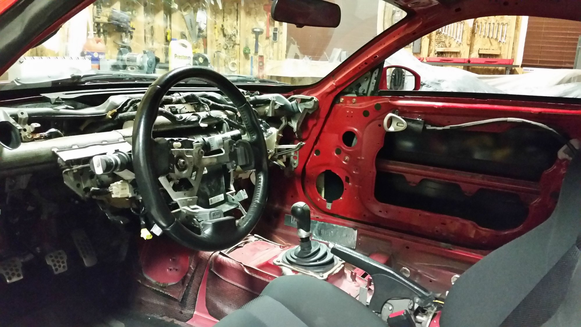

Hey all,
Been posting in other peoples threads and figured its time I just make my own... Had my Z since 2007, did a few track days but primarily focused on motorcycle racing... went to BMW driving school and got TRC level 3 certified for work last year and got the bug to do some car racing... Started prepping the car a few days ago. Its going to be a looooong winter. Cars current state:
Billstien pss10 coilovers
SSR Type F wheels: 245/275 x18 setup
Wilwood brakes up front, stoptechs in rear 13" rotors
SPC control arms
A/C removed
Work in progress:
Picking up lexan sheet for rear hatch and side windows
Gutting in progress
Sifting through wire harness
Prep for roll cage
The last item is what im stuck on. I was thinking of ordering an autopowerindustries weld in cage and getting a shop to weld it in and perhaps do some gusseting while theyre at it but im not sure of the quality of the cage. Heres a link to the website: http://www.autopowerindustries.com/R...350Z-2004-2009
Itd be either item 32174 $500 or 33174 $800... this could keep cost down for my build but I dont want my cage to be poor quality. Any input? I could get the cage welded in for $200-$400 bucks depending on the gusseting I add to it. I called around and a local shop that has built several cages for successful race teams quoted me $1800ish for a 6 point cage Fabrication and weld.
Does anyone have any opinions on this matter? If the autopower cages are legit i might as well save a few bucks. Any thoughts?

So decided to pull the heater core today, anyone have any insight on how to properly bypass the coolant?
Also any advice on cutting out the speaker sheet shelf would be appreciated too. NOt sure if ill have to grind it all the way around to get it off or if you cut enough out you can yank the rest out... seems to be spot welded in some places...
Also pulled the wire harness to trim it down... anyone know what the modules in the pictures are? Ill eventually figure it out by tracing the wires but if someone knows itd make my life easier so i know which one i can chuck and which one i cant (ECM ).
Hope everyone is having a happy thanksgiving!!!

Posts: 2,995
From: Houston, TX
Cut out as much you can to get space, then use a spot weld drill bit. If you get them just right, you can avoid cutting a bunch of holes in the chassis.

The one in the right is the ECU, the one on the left is the BCM, you'll need to retain both of those.
Guessing the instrument cluster connects to the bcm and not the ecm... if this is true I do need to retain it, if not then i wont need it because I have removed everything other than the instrument cluster...
