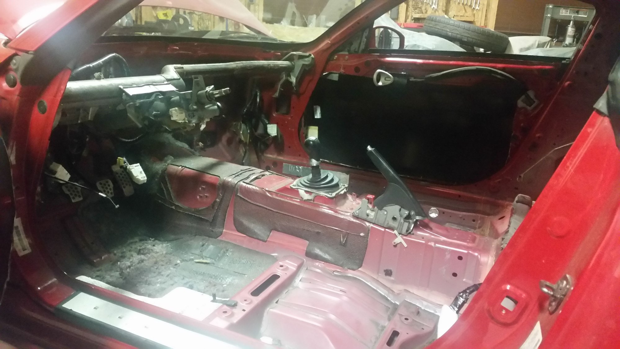

By
Harness cleaned up... didn't have time to go after sound deadening.

This stuff is more stubborn than I thought... stuff under seats is going to be PITA

From: The mitten state
Dry Ice?
Negatory, the hammer should be an indicator of how it went down
Used a small gasket scraper and hammer... wire wheel to clean it up.

The stuff on the firewall was super brittle, I'm guessing from extreme heat cycling... the stuff around the shifter was more of a PITA. The drivers side floor was THE WORST.
Live in Michigan and was mid 40s yesterday.
